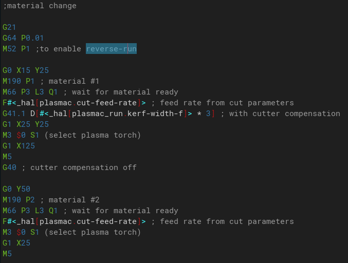

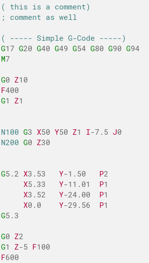

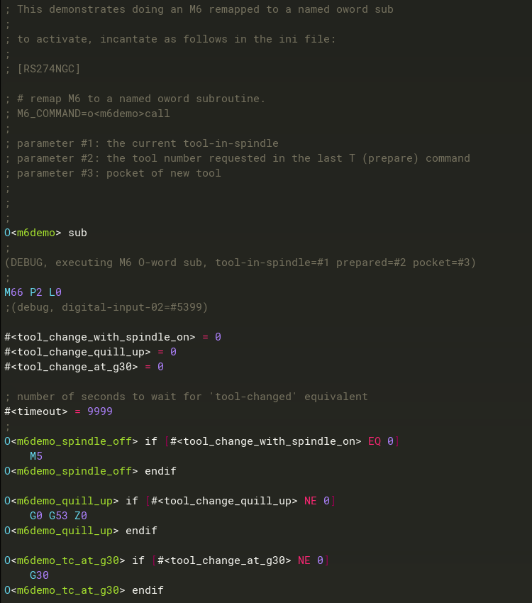

Hi, a long-time lurker here.
I have written a small extension to the python library pygments which is used to highlight code.
The docs/src/source-highlighter for the asciidocs is known to me. And i know gedit is probably used by many users on their controllers. However, most UI for linuxcnc are written in python now. Tinkering with some UI features, I was looking for a way to highlight code with python tools.
Currently, pygments it is missing a lexer for gcode files, though. There is one repository which was addressing this task ( lexers_pygments ) which is likely related to a stackoverflow post .
However, these were quite rudimentary. They only recognized very basic syntax.
Dissatisfied with this condition, I started over to write my own lexer for gcode. You can find it on github .
I would like to discuss the current result with interested parties. Possibly, it could be an alternative to the currently used lexers in other guis.
In the attachments are a few examples with different pygments' styles.
As you see, I choose not to recognize full G-commands, but only the "G", and a likes.
I you have some thoughts about the lexer, I'd be happy to read about them.
Best,
Sebastian
