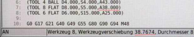

There are countless ways for toolprobing, hard to recommend a workflow.
My way, reducing the chance for crashing the toolseter, tool projection is in the cam tooldata. Then the tool is inserted as required. Previously this data is entered in tooltable, or is there already.
The travel distance to toolseter is calculated, according the tooltable entry. If the toolseter fails, the overshot is minimal. Feed and M52 can be adjusted just before measuring point.

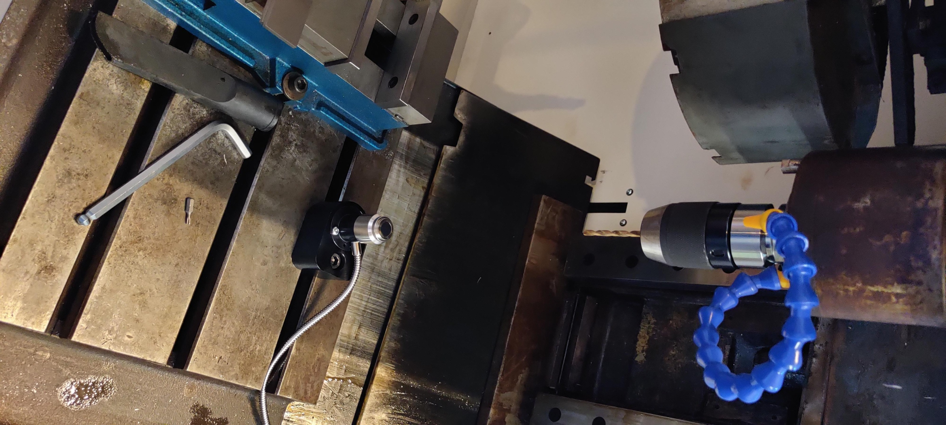

09 Aug 2020 11:32 #177743
by simonmn
Replied by simonmn on topic Mcode subroutine for automatic tool length measuring
Hope I can revive this post.
I took your suggestions and looked into G38. A lot more simple than I thought, and didn't take long to get something working.
Tested it first with bbsr_5a's code, to get a basis, but it seems like a "One tool, one offset" strategy with G92?
Made a fixed mount for the tool setter, so I don't need to pull in a touchplate to touch tools off.
I also really liked the idea of rough measuring your tool, and typing that into the tool table. aka, having the tool length being the distance from spindle nose, to tool tip. Kind of like MaHa showed and empireages talked about.
Now I'm a little unsure how to set this up on the machine. How do I make it so, that the tool length is the actual tool length from spindle to tip?
Here is the updated gcode I am playing around with, if it can help.Am currently playing alot with macros, both at work and at home, hence the ini variable calls.
Hope you can point me in the right direction
Thanks for the help.

10 Aug 2020 07:53 - 12 Aug 2020 06:21 #177803
by MaHa
Replied by MaHa on topic Mcode subroutine for automatic tool length measuring
From retracted Z (G53 Z0), you need to know the distance from spindle to trigger-point of toolsetter.
(If possible, probe the spindle, #<P1> = #5063)
(If possible, probe the spindle, #<P1> = [#5063 + #[5203 + [#5220 * 20]]])
Keep this as negative value, eg #<P1> = -350
After probing your tool, #<TOOL_L> = ABS[#<P1> - #5063]
After probing your tool, #<TOOL_L> = ABS[#<P1> - [#5063 + #[5203 + [#5220 * 20]]]]
EDIT:
Sorry i gave misleading information. As #5063 probe result is related to active Z-offset, the correct way to get the absolute position is:
Probe trigger point absolute position = [#5063 + #[5203 + [#5220 * 20]]]
or
on probe contact, then G28.1 before lift off from probe, #5163 should give the same result.
EDIT:
or
Last edit: 12 Aug 2020 06:21 by MaHa. Reason: Incorrect information
