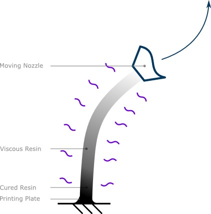

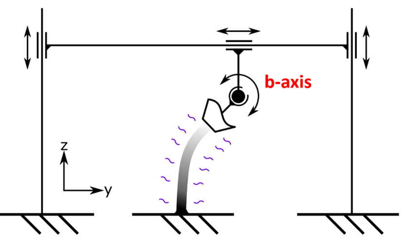

In the figure attached (principal_setup_printer.png) you can see the principal setup of our printer which will be used for print operations during microgravity conditions on a parabolic flight. The printer extrudes a viscous resin which is cured by UV-LEDs while printing.
In one of our experiments we want to print a curved rod (curved_rod_example.jpg). The path of the nozzle tip should be composed of two circular segments. For that purpose, we could use the Cubic Spline G5 command. But with that command we can only move in a fix plane. For a curved rod we also need to rotate the b-axis in such a way so that the angle of the nozzle-axis is tangential at every point on the circular segment. Is there any possibility to mix the cubic spline command G5 together with a linear command G1 for the rotation of the b-axis at the same time?
So far we have a setup where we integrated an own kinematic which compensates the movement of the nozzle tip. So all movements are referred to the nozzle tip.

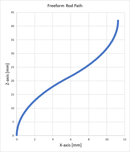

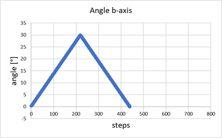

For the curved rod we have already generated and tested an example code which is attached to this post (gcode_of_curved_rod.ngc). There we only use G1 commands together with G91 commands for the incremental path of the nozzle tip and the corresponding angle for the b-axis. When we load the code into LinuxCNC the print path of the nozzle tip is displayed correctly. On the figures attached you can see the path and angle that results from the attached g-code (path_that_results_from_gcode.png & angle_that_results_from_gcode.png).
