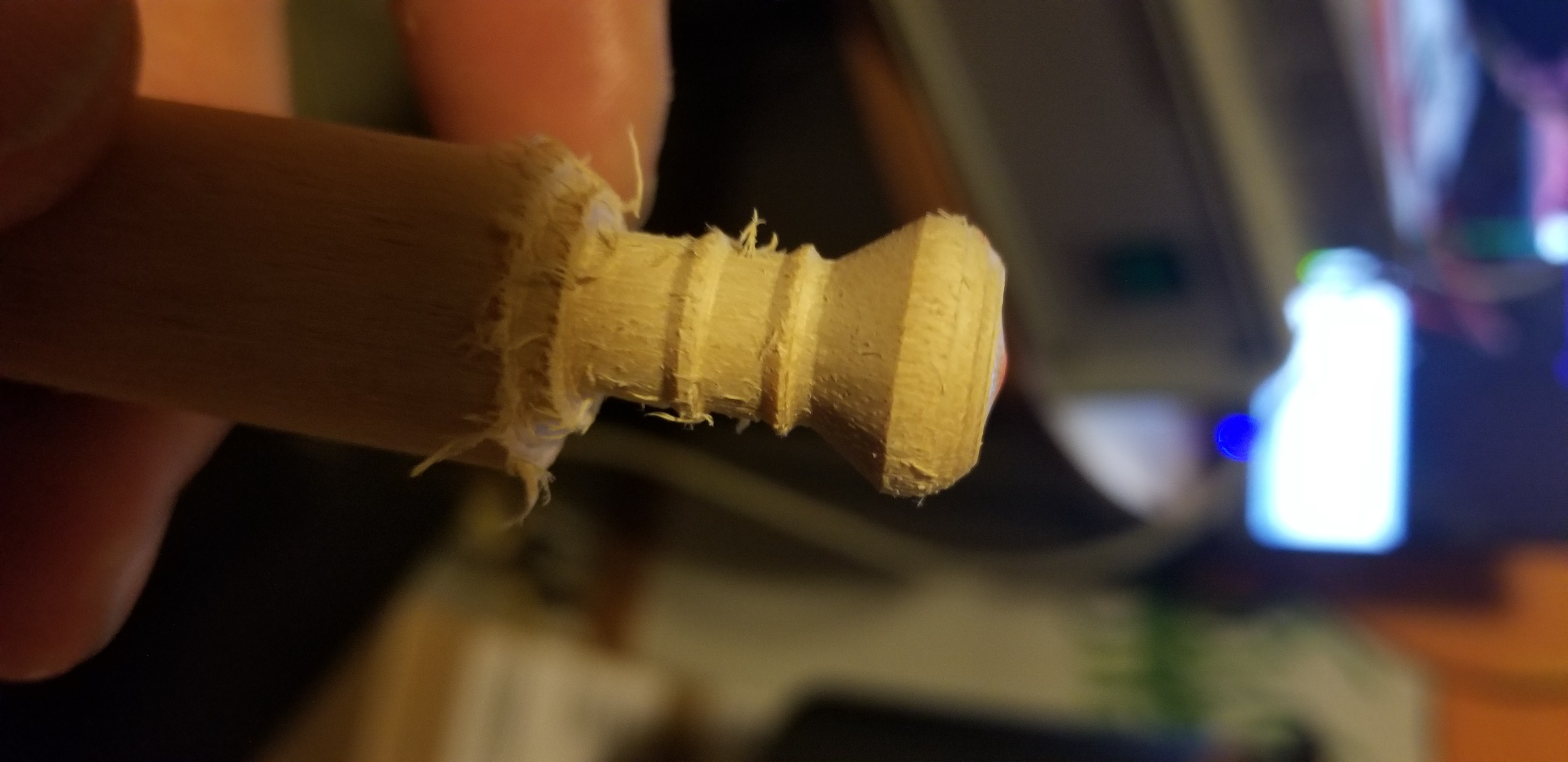

no encoder, but we have a winner. I added in a "setp spindle.0.speed-in 100" into the HAL and have movement.
Still having no movement on the retract Z move though.
  • Flyer007
  • Flyer007's Avatar Topic Author
  • Offline
  • Junior Member
  • Junior Member
18 Nov 2020 21:53 #189734 by Flyer007
Replied by Flyer007 on topic Lathe pauses at N21
Success! With all the testing I went back to F360 and redid the post processing. All good now and roughed out a design I made.
Thanks everyone!
