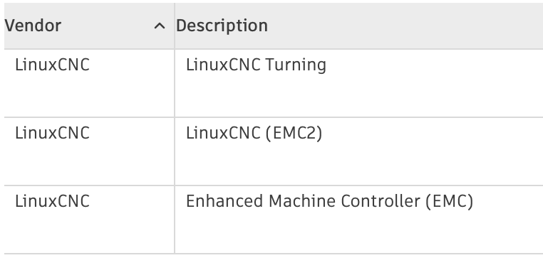

- Posts: 19899
25 Feb 2023 11:48 #265315
Replied by andypugh on topic radius to end of arc differs from radius to start
It makes no sense that it should not work one day but work the next.
Did you restart the system between the two attempts?
This might be due to being in metric or imperial mode, as the required number of decimal places is different.
Which postprocessor are you using in F360? I have never seen this issue with the one that I use.
- Pudding1960
- Posts: 16
26 Feb 2023 00:50 #265374
by Pudding1960
Replied by Pudding1960 on topic radius to end of arc differs from radius to start
It all makes no sense..
I Restartet the system many times without success,the next day it works fine ! My Postprocessor is EMC and i had no issues exept this ....
- Posts: 19899
27 Feb 2023 00:08 #265454
Time to create page: 0.180 seconds
