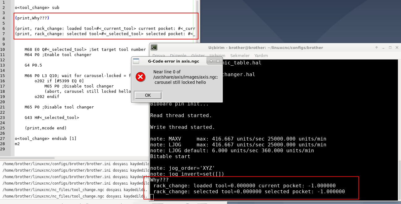

[REMAP FOR M6] Why does linuxcnc run the .ngc file on startup?

28 Aug 2021 11:36 - 28 Aug 2021 11:42 #218983
by mugurlu
[REMAP FOR M6] Why does linuxcnc run the .ngc file on startup? was created by mugurlu
Last edit: 28 Aug 2021 11:42 by mugurlu.
28 Aug 2021 11:47 #218985
Replied by andypugh on topic [REMAP FOR M6] Why does linuxcnc run the .ngc file on startup?
Do you by any chance have an M6 in the [RS274NGC]STARTHUP_GCODES in the .ini file?

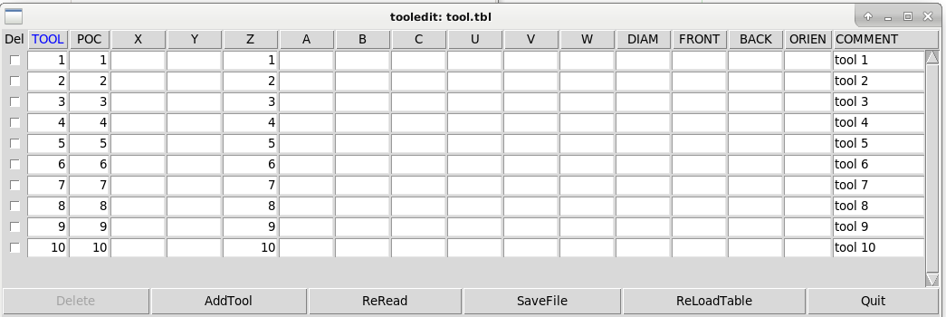

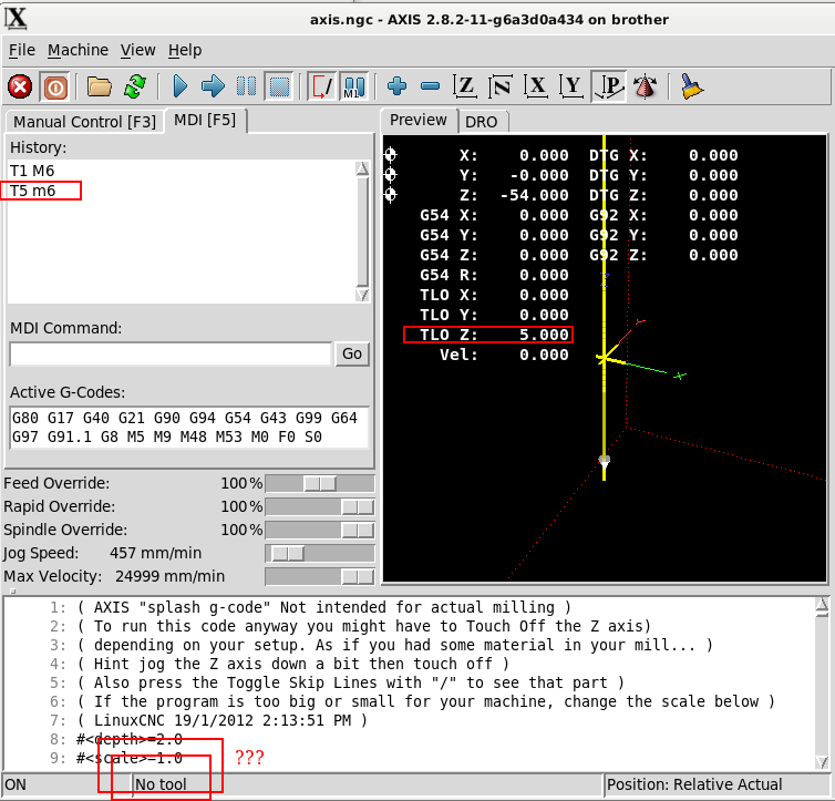

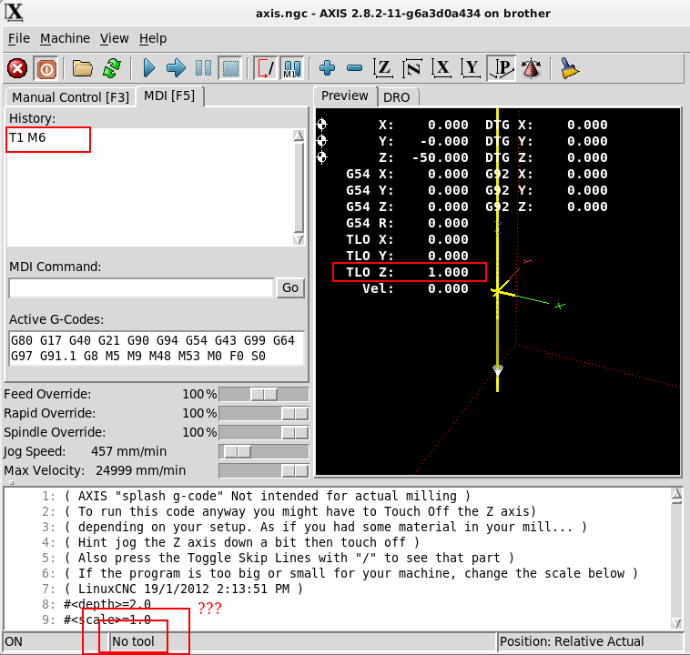

28 Aug 2021 11:55 - 28 Aug 2021 12:14 #218986
Replied by Aciera on topic [REMAP FOR M6] Why does linuxcnc run the .ngc file on startup?
Not sure why it's running at startup.
But as to why you have a tool offset but no tool loaded:
In line 23 of your 'tool_change.ngc' you are only telling the controller to enable tool length compensation using the tool length offset value of the 'selected_tool' but you never actually tell the controller to change the tool.
Note that you can actually use M6 inside a custom remap:
Have a look at section 5.6 here:
linuxcnc.org/docs/html/remap/remap.html#...lated_codes_t_m6_m61
So maybe changing line 23 to this will do what you want:
T#<_selected_tool> M6 G43

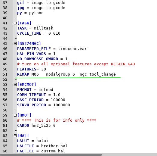

28 Aug 2021 12:57 - 28 Aug 2021 13:01 #218995
by mugurlu

[RS274NGC]
PARAMETER_FILE = linuxcnc.var
HAL_PIN_VARS = 1
NO_DOWNCASE_OWORD = 1
# turn on all optional features except RETAIN_G43
FEATURES= 30
REMAP=M06 modalgroup=6 ngc=tool_change

Why does it stay in No Tool status? (P3 ... P4.png P5.png)
