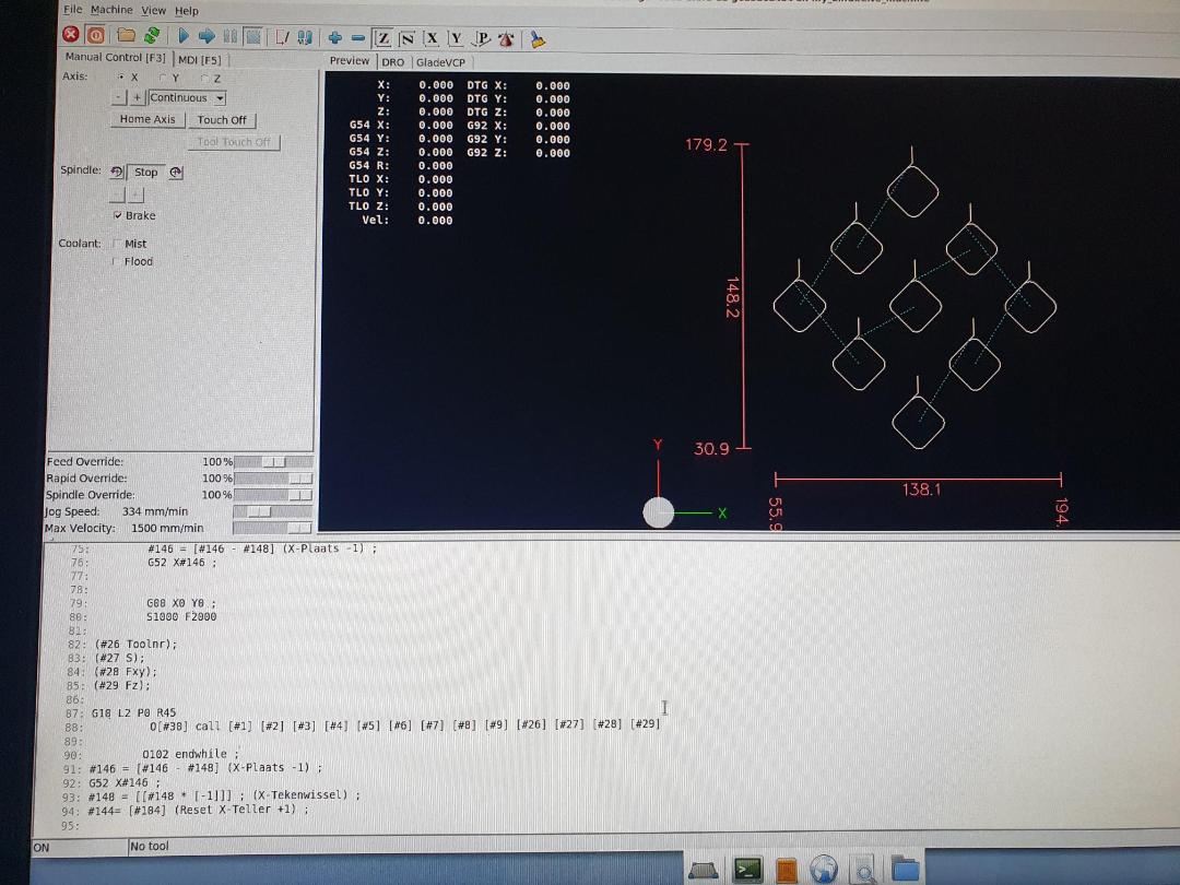

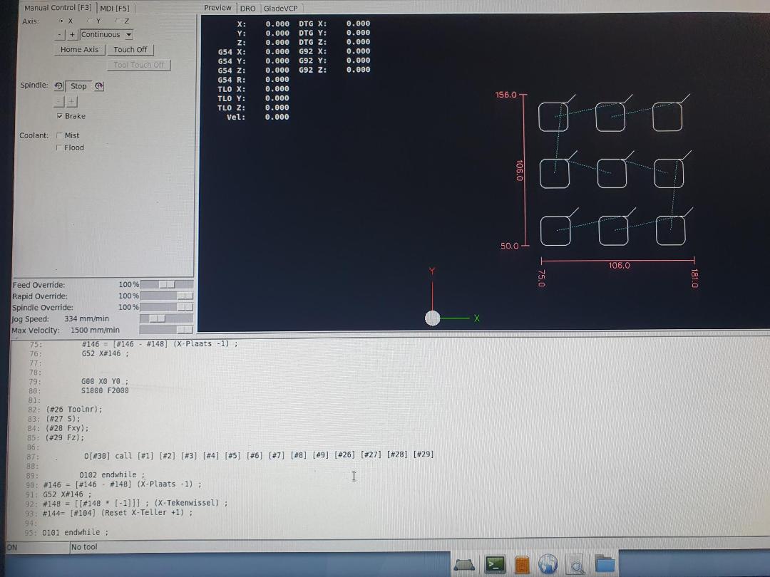

I came to the same conclusion, as I found G10 L2 P0 R45 is not correctly working.
(In comparison with my experience)
My setup:
A base program that calculates a point to point patern depending on the settings of Variables
In essence the zero is in middle of the patern and then shifting by a G52. to have all Zero's on the calculated points, so a subprogram can be executed on this calculated Zero (point).
The main program will on very point do an O-call to execute a subprogram.
So in short, by example; A patern of 3*3, distance between the points is X20 Y20 and execute O53 on every (zero)point.
See pic "No rotation"

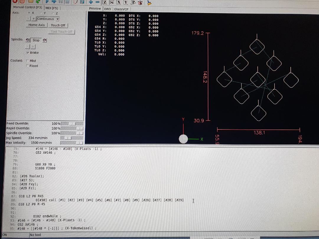

Now I want to rotate the subprogram on every point.
So before the O-call of the subprogram I put
G10 L2 P0 R45 in the main program.
and after the O-call of the subprogram I write
G10 L2 P0 R-45
to put the coordinate system again to it's original position,
as a new G52 will follow, to navigate to the next point without the rotation.
What happens is that the whole base program is shifted by 45° instead of every subprogram around it's proper Zero point).
Pic R45
And more strange the -45 gives a logic that I can not explain. (different values R315 do not work neither).
Pic R45 & R-45 (look at the logic of the points (dashed lines)
