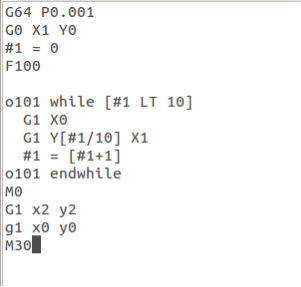

hi,
When I use the G code, I see that M2 and M30 both end the program, M2 ends directly, and M30 ends after changing the pallet shuttle. How should I test this? How to distinguish between them?I can't see the difference between them . m2-m30,

From src/emc/task/emccanon.cc
void PALLET_SHUTTLE()
/*! \todo FIXME-- unimplemented */

Replied by andypugh on topic How to use M2 and M30?
I wonder what this ought to do?
Is it as simple as driving / responding to pins pallet-shuttle and pallet-shuttled?

Yes, I want to demonstrate the functions of M2 and M30, but I don’t know how to test M30. It has the same function as M2. How to test M30?Or how can I show the difference between M2 and M30?I wonder what this ought to do?
thanks,chen

I think that the only difference between M2 and M30 is a call to PALLET_SHUTTLE, which does nothing:
github.com/LinuxCNC/linuxcnc/blob/master...erp_convert.cc#L4389
It is interesting that in all the time that I have been working on LinuxCNC no-one has asked why pallet-shuttle does not work.
