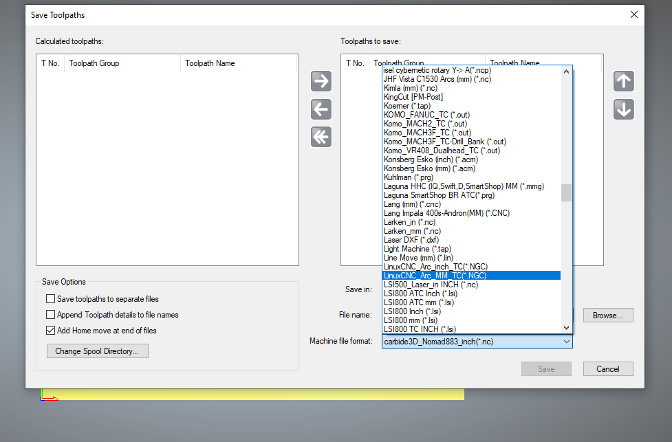

post your gcode file. That might help for others to troubleshoot.

Replied by andypugh on topic Small spindle crashed
It sounds like, possibly, the Z axis stalled.
What happens if you MDI a G0 Z (high) with the spindle running?
(I was going to suggest G53 G0 Z0 but then realised that perhaps you are not configured with Z at top of travel.)
I assume that you have checked the G-code?

I think what hapened is that the Z-carrage is too heavy for the Z-motor.
I think the Z-motor missed the steps going up.Eventhough the Z was driving at 180 mm/minute.
This is the G-code
My best regards
Philip
