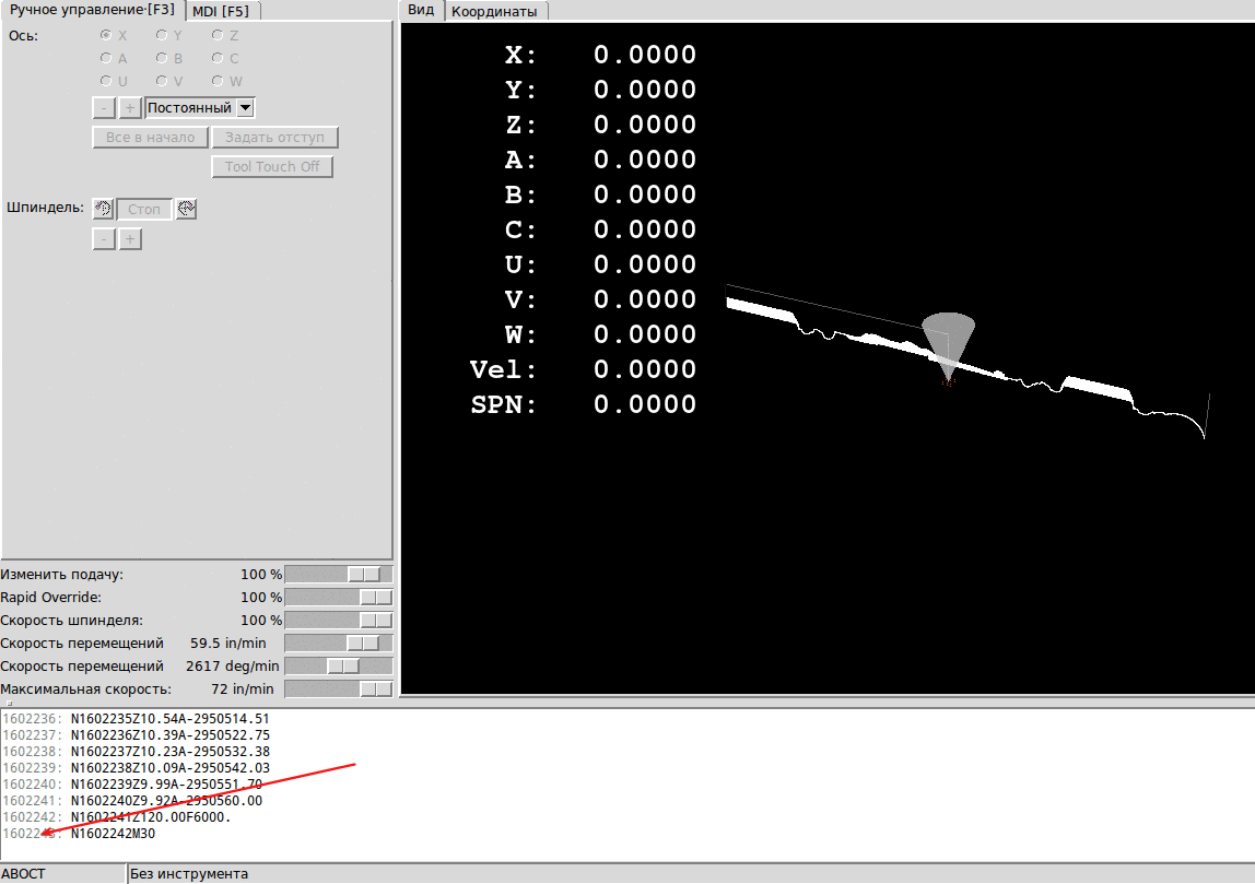

How many lines of G code can linuxcnc execute at most?

11 Nov 2021 08:40 #226080
by nkp
Replied by nkp on topic How many lines of G code can linuxcnc execute at most?
I think it depends on the amount of memory in the computer)
- Posts: 19896
- Thank you received: 4648
11 Nov 2021 09:04 #226083
Replied by andypugh on topic How many lines of G code can linuxcnc execute at most?
I think that there would be a problem if the number of motion-id codes was more than 2,147,483,647 as it is held in an int.
That would be a program with at least that many lines, and possibly many more as only commands that cause motion get an ID.

11 Nov 2021 09:32 - 11 Nov 2021 09:34 #226085
by nkp
Last edit: 11 Nov 2021 09:34 by nkp.
The following user(s) said Thank You: Michael, wang
