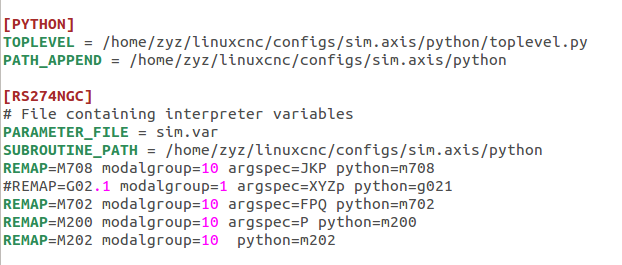

I define a remapping code (M702, used to set the parameters of the external device,it can be executed normally)
and use it in the remapping code (yield INTERP_EXECUTE_FINISH).

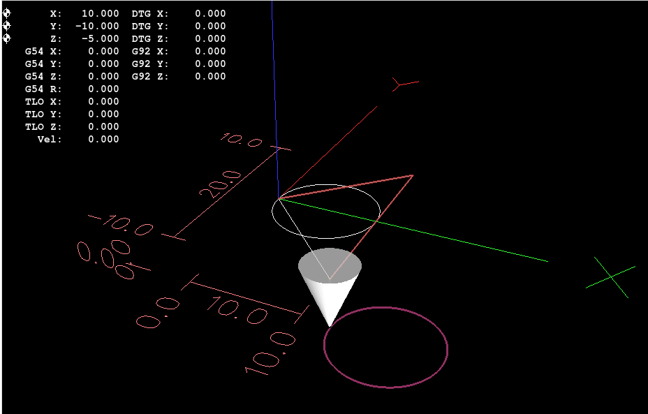

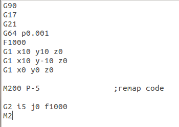

It can make my code execute in order, but when I When defining multiple remapping codes,
it is found that some remapping codes will skip the line of G code before it.
Is my usage method incorrect? How should I solve it? I use Linuxcnc 2.9
Thank you in advance for any reply.
Below is part of my code and configuration:
