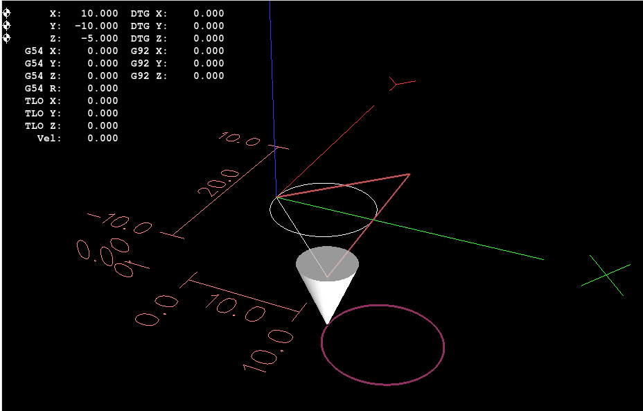

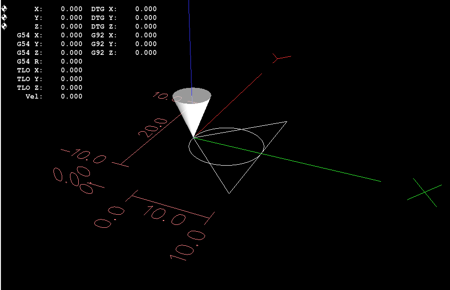

I have defined multiple remapping codes (M702 is used to set the parameters of external devices, and M200 is used to receive ethercat's io signal and control the movement of the Z axis).
I use (yield INTERP_EXECUTE_FINISH) in the remapping code, which allows my code to be executed sequentially in the file, but when I tested it, I found that only the M702 defined by me would not destroy the G code file.
When using other remapping codes Line skipping will occur (for example, skip the line of G code before M200 when using M200).
Is there a problem with the use of the (yield INTERP_EXECUTE_FINISH) function?
How can I solve it? I use Linuxcnc 2.9
Thank you in advance for any reply.
Below is part of my code and configuration:
remap.pyiningc
remap.py

;M702 F20 P50 Q1
M200 P-5 ;remap code
G2 i5 j0 f1000
M2Attachments:

Replied by cmorley on topic Using remapping code will cause the G code to jump to execute?
starting the remap with 'yield INTERP_EXECUTE_FINISH ' does nothing.
This command should be called _after_ you add your code that needs to wait for events. (such as probing or reading HAL pins)
