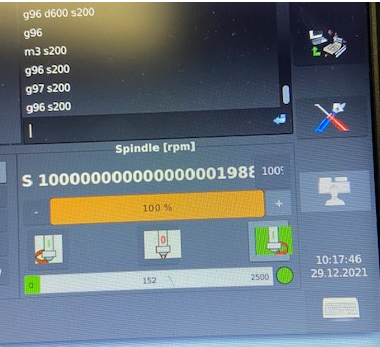

I would like to manualy start my lathe spindle in CSS mode using G96 S400 M3. Doing so starts the spindle but even though the status shows G96 active, it is not in this mode. Variying the X diameter does not change spindle speed.
If I start the spindle and with a simple M3 or G97 and then issue a G96 it seems to enter G96 mode. But if I enter the G96 too soon after the G97, it also shows as being in G96 but actualley still operting in RPM mode.
Does anyone know the requirments before a G96 will become active?
Also, when I enter the G96 in the MDI using gmocappy interface, the spindle speed text box changes to this huge number like
100000000000000000198
Does anyone know why that would happen?

If you enter G96 ... D3000 do you see 3000?
The huge number problem looks like a divide-by-(nearly) zero.
What is the axis.x.position-fb ?

There is a joint.0.motor-pos-fb. It is the current radius in the Radius DRO
If I use the D option It does lock to the maximum RPM instead of the large number.
Maybe I need to give a little more information.
When I type G96 S300 M3 into the MDI command input, the spindle DRO flashes quickly from a very large number to S300,
However, what I am actualey doing calling these commands from a glade python script. Here I use the following code. You will see a 2 second delay I added to get the G96 to actualley work. When this is called the spindle DRO stays at this large value. The Radius DRO is a large number when I call this code so there should not be a divide by zero due to the X being at position zero.
def set_spindle(self, mode):
speed = self.builder.get_object('RPM').get_text()
css = self.builder.get_object('hal_CSS').get_active()
self.set_mdi_mode(True)
if ( mode == 1 ):
dr = 'M3'
elif (mode == -1):
dr = 'M4'
if ( (mode == 1) or (mode == -1) ):
self.command.mdi('G97 s{} {}'.format(speed, dr))
self.command.wait_complete()
if ( css ):
time.sleep(2)
#self.command.mdi('G95')
#self.command.wait_complete()
self.command.mdi('G96 d2500 s{} {}'.format(speed, dr))
else:
self.command.mdi('M5')
self.set_mdi_mode(False)
