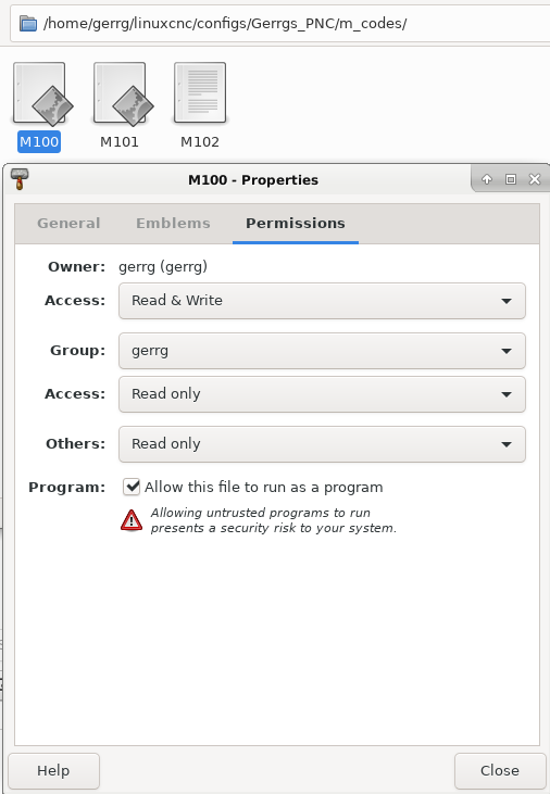

Have you set the M100 file to be executable?

If I right click on the M100 file and go to permissions, it has "Allow this file to run as a program" checked... so I think that's right.

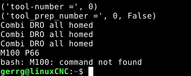

When i run linuxcnc through the terminal with the &, I home my machine and then send a "M100 P66" command, and it says command not found. I'm glad you told me about the 'linuxcnc &" terminal command. That's very helpful for debugging!
it sounds like it's not seeing the M100 file, or least not as a command, so that's a step in the right direction towards figuring things out! Thoughts on what to check next?

When running an M1xx code from the command line, it must be executed as a bash script. So you would type "bash M100 66". (Note that you do not use the P.) And you must be in the dir the file is located.

Okay, so I went back out and went to my m_codes folder in the terminal again. started up linuxCNC and did "bash M100 66" and it did infact change the value (I also had it echo out the value, and that worked too. So that's good at least. I had some blank lines which were giving a problem at first, but i just deleted those and it worked fine from the terminal after that
then i went to the linuxCNC program and the MDI tab and entered "M100 P72", but the value didn't change at all. I also put a copy of the M100 file in the NC folder and tried it from there (both with and without the m-code path in the ini file), but couldn't get it to work from either place, or any combination of path in the ini file (or the entire m code path line commented out entirly). the terminal command always worked, but never worked from the MDI tab.
I don't think it's a problem, but i kept getting a message in the terminal ":numeric argument required". it would still run the bash command from the terminal though and would change the value, so it's all a step in the right direction i think.

1) The M-code really should run as an executable, but Linux requires a dummy path in front of random executable files.
So try uncommenting the echo telltale, moving to the mcode directory and issuing the command ./M100. That should work, without the bash command.
2) It is just about possible that /bin/bash isn't the path to bash on your machine. You could try #!/bin/sh instead.
First get the script working as a standalone executable (./M100 or from hour home folder ./linuxcnc/configs/Gerrgs_PNC/m_codes/M100

okay, so everything seems to work now except for the user_M_path directory. Here's what i've done to get it to work.
when using the ./M100 from the directory, it was giving me a "/bin/bash^M: bad interpreter" which looked like there was a hidden character in there. I tried editing the file from nano (just deleting that line and re-writing it) but that didn't seem to work. So then I just deleted the whole file and re-wrote it in vi (just "sudo vi M100"), and that seemed to make it work correctly from the terminal without adding bash infront of it.
Tested it out first with the callout "USER_M_PATH = /home/gerrg/linuxcnc/configs/Gerrgs_PNC/m_codes/" in my INI file, but no sending the MDI command still didn't change anything. After commenting that line out so it points to the nc_files folder, I restarted everything (and moved new M100 file to the nc_files folder), and it worked! I might fiddle with stuff a bit more to try to get the M codes into a folder (either in the config file or the NC_files folder), but for now it works, so that's the biggest problem solved.
I typicaly use notepad++ on my windows PC to edit any text files on my linuxCNC PC, so i'm guessing that's where the extra hidden characters popped up. I'll try to find an easier work around than using vi since it's a bit funky to me, but I can at least make it work, so that's good. If anyone has any other advice, I'd be glad to hear it, but thanks everyone for helping me get this fixed!

I use Notepad++ a fair bit, you can set it to show all characters to be sure what is going in, and choose the line end style by double clicking where it (should) say Unix (LF) on the bottom right of the window.
Maybe the file was being saved in a bizarre encoding?
