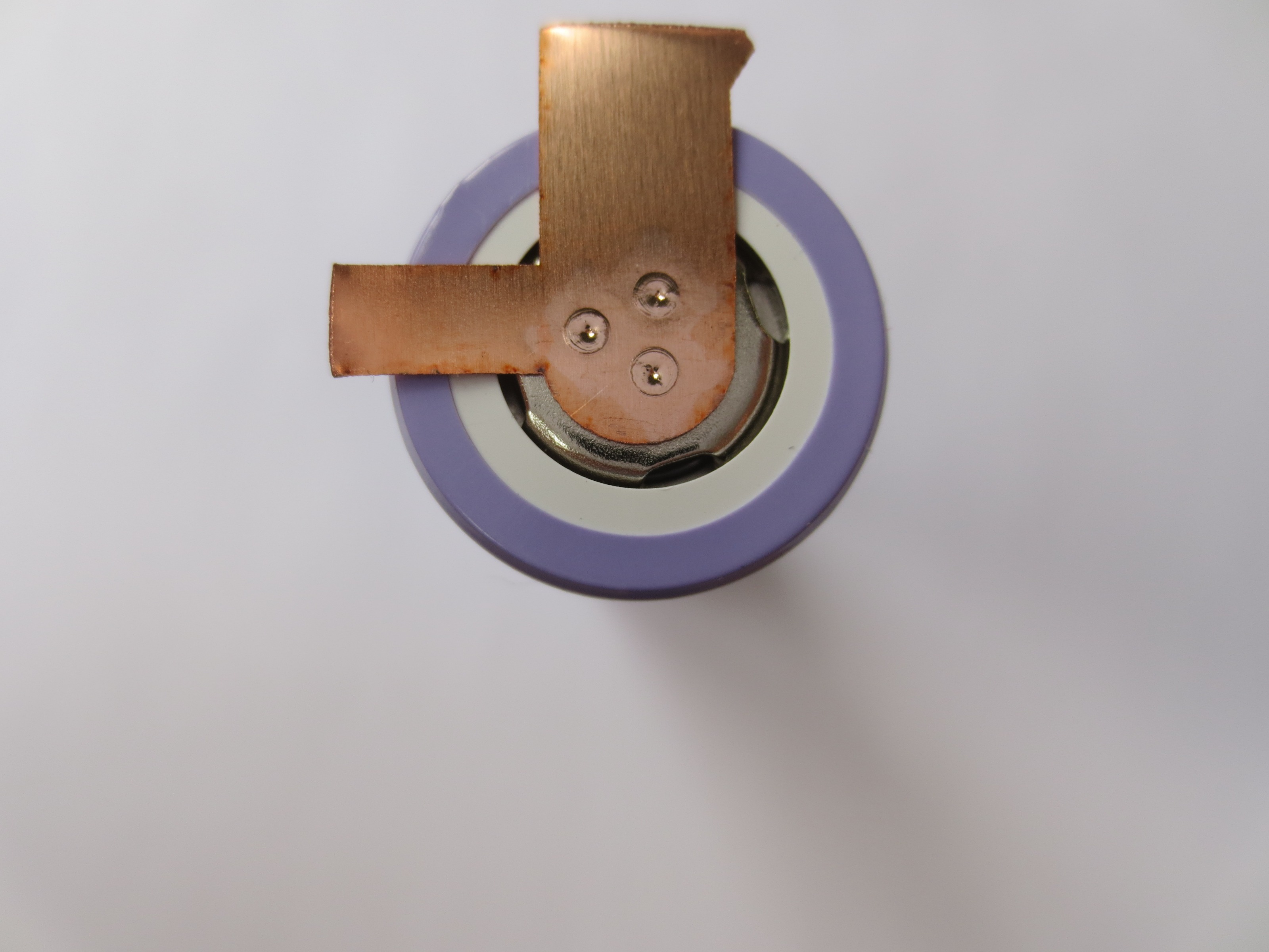

I would like to use a special torch to weld copper cell connectors onto lithium-ion cells. Any number of spot welds can be set on a cell. These spot welds are located on an imaginary circle that is coaxial with the center of the cell. The parameters for each battery cell in the pack are: - X and Y coordinate of the center of each cell - Circle diameter on which the spot welds are located - Number of spot welds on the cell So I need a file that contains this information for each cell. A loop runs in the main program. The loop counter corresponds to the index to access this information. I hope you now understand a little better what I intend to do.
In the Image you see a cell with three welding spots.
thanks for your quick reply.

I will need something like a multi-dimensional array to store the data for each cell.
1. dim: Cell number
2. dim: X-location of cell centre point
3. dim: Y-location of cell centre point
4. dim: circle diameter on which the welding spots are located
5. dim: number of welding points
1. dim: Cell number
