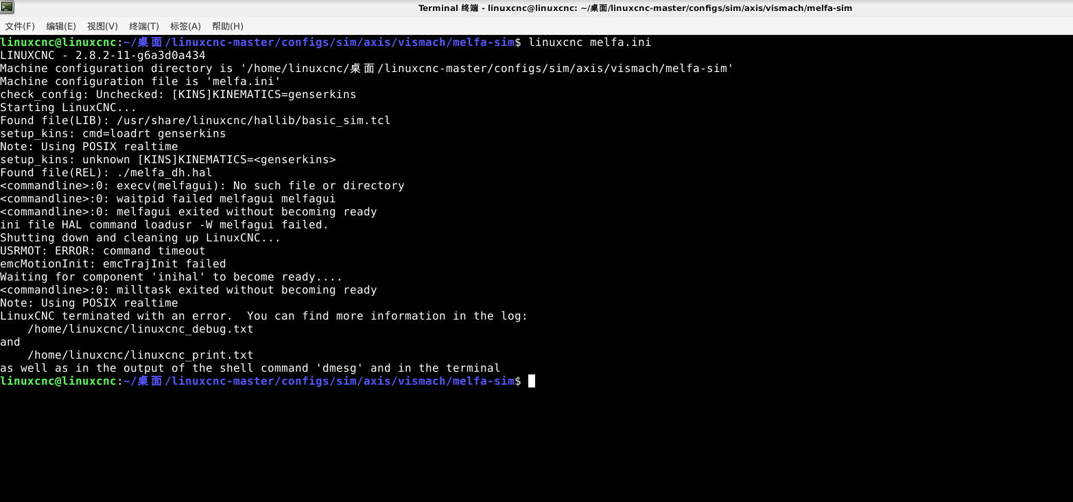

I downloaded the file you gave me, put it on the desktop, open it with the terminal, and found an error. Is this caused by version 2.8.2? I put the picture below
What I meant is that you might want to browse the linked simulation config folder to read the various comments. For example how to switch from world to joint mode in G-Code in the "example.ngc" or the M-code remaps (M428, M429) in the folder "remap_subs".
To actually run the sim config you will need to install version 2.9 (see below) and then you will find the linked config in the config selector to run it.
