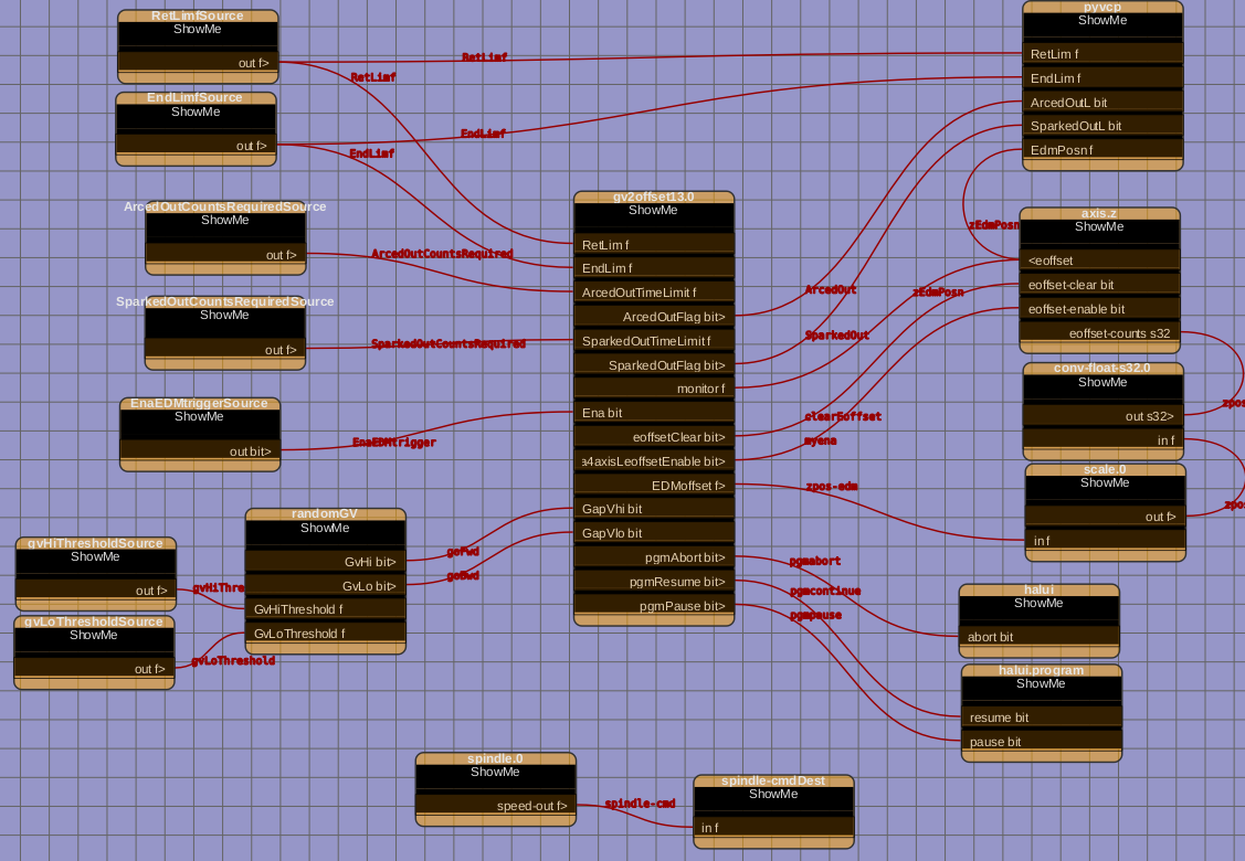

04 Aug 2022 05:50 - 07 Aug 2022 06:08 #249004
by tjtr33
Replied by tjtr33 on topic How to make M1** execute Gcode
I dont knopw if this will help
but I use M1xx to move
Theres a comp i use
and it changes modes from auto to Pause
and the motion destination is set by a seperate Mcode
My effort is for EDM
Yours is PickAnPlace
But the use of MoveWhilePaused is similar
Mine uses a single axis but can be modified
Yours would like have motion with some waypoints
that is, move UPtoClearHeight then XYtoPartWanted then DownToGrabPart then XYtoOverDest then DownToPartDestHeight
All this could be done using machine coordinates
This idea does NOT use Gcode, just destination positions
This code does NOT use PID Accell/Decell
This idea ends at same position where it began
That allows the mode reversal back to Auto without any jerk.
I attach the comp code and the hal wiring as png's
hth tomp
Theres a comp i use
hth tomp
edit 07aug2022
in python script use
import sys, subprocess
then build your command string
like cmdstr = "halcmd setp testEtab.0.mypin"
and add the value to be set
like cmdstr = cmdstr + str(myval)
then have the system exec the cmdstr
like
subprocess.call(cmdstr, shell=True)
loop that recipe thru all the pins to be set
hth tomp
watch in action
subprocess.call(strg5, shell=True)
Last edit: 07 Aug 2022 06:08 by tjtr33. Reason: example code & video link added
