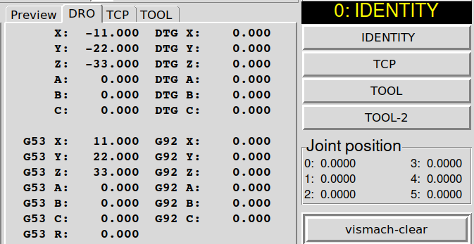

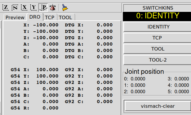

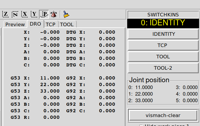

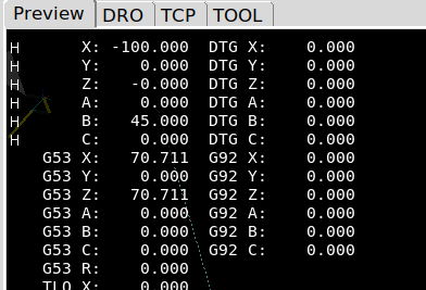

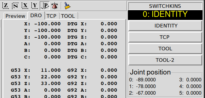

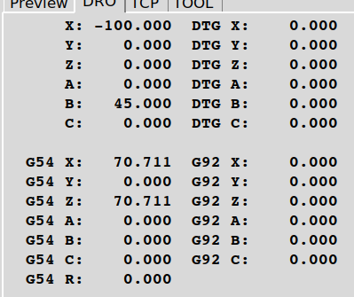

10 Feb 2023 15:25 #264227
Replied by Aciera on topic Change work offset values in a Pure Python remap w/o self.execute()
Just an update in case somebody comes across this in the future as there are some odd thing with this:
1.
emccanon.SET_G5X_OFFSET(0, P[0], P[1], P[2], 0,0,0,0,0,0)
With index '0' seems to write to G53 and the axis DRO is then stuck at G53
A 'G53 X0Y0Z0' ignores the new values and uses the old offset (x100y0z0 in my case)
2.
emccanon.SET_G5X_OFFSET(1, P[0], P[1], P[2], 0,0,0,0,0,0)
With index '1' seems to write to G54 just fine but also doesn't seem to update G53 properly.
So a 'G53 G0 X0 Y0 Z0' will ignore the offset-change with the above emccanon.SET_G5X_OFFSET(...)
If anybody has an idea I could get this to work please let me know.
This is the code I'm using:
1.
2.

I start the config, home the machine and in MDI I set G54 and command to go to machine home:
g10 l2 p0 x100 y100 z100 a0 b0
g53 g0 x0 y0 z0
Nothing moves since we are already in home position and the DRO (as expected) reads:
Now I call a G69.9 remap that looks like this:
def g699(self):
emccanon.SET_G5X_OFFSET(0, 11, 22, 33, 0,0,0,0,0,0)
yield INTERP_OK
and the DRO changes to this:
then do an MDI call to go to machine home position: g53 g0 x0 y0 z0
and I get this:
and a follow MDI command: g54 g0 x0 y0 z0
gives me this:
l don't get it.
