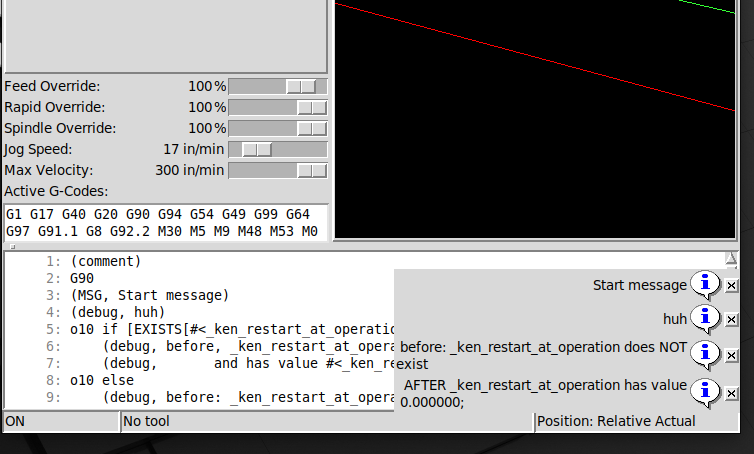

Running on a Sherline Mill.
Trying to debug stuff, getting weird behavior.
I swear I can't see any bugs!
Started with::
When I run this, in the "messages" window, all I get is:
If I take out the first (debug, huh), I get
"(MSG, Start message)" is never output
"(debug, huh)" is never output
only 1 of the 2 "debug" in the "if" clause is output
I have to be missing something, but I cant see it
(a more confused than normal) Ken

Code:
(comment)
G90
(debug, huh)
o10 if [EXISTS[#<_ken_restart_at_operation>]]
(debug, before, _ken_restart_at_operation exists)
(debug, and has value #<_ken_restart_at_operation>;)
o10 else
(debug, before: _ken_restart_at_operation does NOT exist)
o10 endif
#<_ken_restart_at_operation> = 0
(debug, AFTER _ken_restart_at_operation has value #<_ken_restart_at_operation>;)
M30
Code:
1 - before, _ken_restart_at_operation exists
2 - AFTER _ken_restart_at_operation has value 0.00
Code:
1 - and has value 0.00
