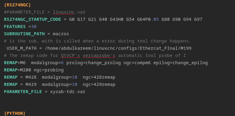

how to make an m code that runs a python script
- Posts: 4819
- Thank you received: 2177
27 Oct 2024 10:04 #313309
Replied by Aciera on topic calling python file
1. add this to the [RS274NGC] section of your ini file:
2. save your python script as eg 'M123' (possible numering is 100...199) to the 'mcodes' folder in your machine config directory and mark the file as executable
3.'M123' in Gcode should now execute the script.
USER_M_PATH = ./mcodes2. save your python script as eg 'M123' (possible numering is 100...199) to the 'mcodes' folder in your machine config directory and mark the file as executable

I did as you said but i get an error of unknown m code

- USER_M_PATH is incorrect (this is supposed to point to the directory that contains your 'M199' file not to the file itself )
- File name is incorrect (Do not add an extension eg .py)
- The file is not marked as executable
No, this is not a remap, it's a custom mcode (which lets you use any executable script)
Possible causes:I did as you said but i get an error of unknown m code
do i need to add REMAP = M199 python = M199(the name of the script)

Thank you i solve the issue by removing the .py extension and adding it to the right directory
