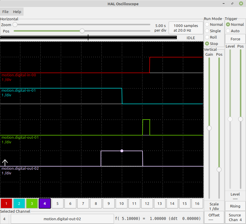

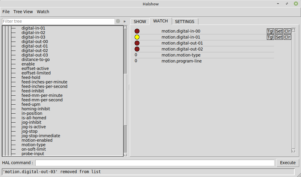

I have configured a hydraulic tailstock on a CNC lathe. It has 2 valves (in/out) and 2 proximity sensors (min/max). I want to use M-codes to control the tailstock, but I can't get M66 to work. M64 and M65 do work properly. I've attached the sensor inputs to motion.digital-in-00 and 01. I can see the signals changing low/high in halshow. But when I try to test this functionality with a small G-code file, it keeps waiting on the M66 line.
It keeps waiting on line M66 P1 L4 Q10. Even if I manually turn the sensor on/off, it doesn't do anything. But when I use this line in MDI, it works without problems. When I use MDI I can see the gmoccapy interface "freeze" when I execute this line. It "unfreezes" when the sensor is operated.
Why doesn't my G-code work?

L3 is correct for this application, but out of interest, does L1 work?
Does the 10 second timeout work?
Which LinuxCNC version?
In halshow are you looking at the motion.digital-in pins? (rather than the IO pins)

The other L-modes also don't work. Timeout doesn't work. Nothing happens after 10 seconds. Yes I'm looking at the digital-in-xx pins. LinuxCNC version on the splash screen is 2.9.0~pre1+git20230208.f1270d6ed7
