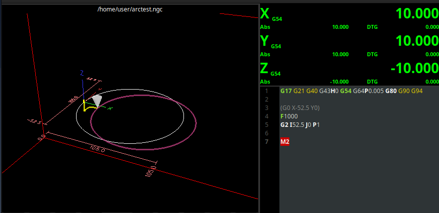

Hello,
I was planning to bore out a disc yesterday and thought I'd handwrite the code. The circular path would be 105 mm in diameter with the center at G54 X0, Y0, and starting at position X-52.5 Y0. Because of my lack of experience, I wrote is as a small program so I could get a preview. But the preview is not what I expected for the:The arc is started from position X-52.5, Y0.
As you can see in the screenshot, the preview shows a strange linear movement and a counter clockwise helix. But when I run the code, the machine makes a 105 mm circle in the XY plane, just as I wanted. The path from this run is visible as well (the red line). I'm guessing I'm doing something wrong, but what?
G2 I52.5 J0 P1As you can see in the screenshot, the preview shows a strange linear movement and a counter clockwise helix. But when I run the code, the machine makes a 105 mm circle in the XY plane, just as I wanted. The path from this run is visible as well (the red line). I'm guessing I'm doing something wrong, but what?

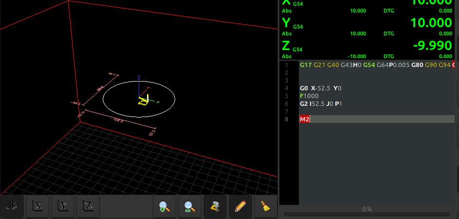

The complete code was visible in the screenshot, but for clarity I include it here:
I made a new test with the code you used, and for that the preview is working properly. But if I comment out the G0 move, then the preview is again strange. See the two situations below.
The complete code, with G0 commented out is below:
Maybe this is expected behavior? It certainly wasn't what I expected, but that doesn't mean much. I use LinuxCNC 2.9.2 by the way.
Thank you for having a look. With that the issue is now pinpointed.

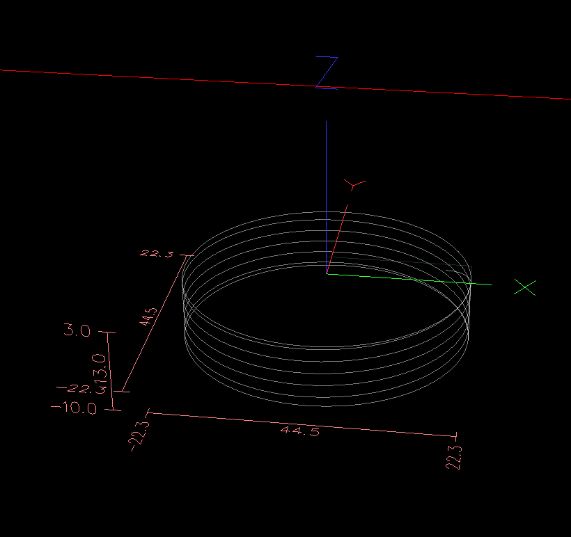

Yes, helix milling was the end goal. But I was trying to build the program as simple as possible to start with, because I have little experience with anything else than G0/G1. But I got stuck because the preview did not show what I expected for an in-plane (XY) circle.

This toolpath is at centerpoint, so don't forget cuttercompensation. If G41/ / G42 makes trouble, whats not unusual, it can be solved like that. Parameter #5410 is tooldiameter of loaded tool.
G0 X-[52.5 - [#5410 / 2]] Y0 Z0
F1000
G2 I[52.5 - [#5410 / 2]] J0 Z-10 P5Please Log in or Create an account to join the conversation.

09 Mar 2026 15:22 #344068
by Hannes
Replied by Hannes on topic Strange preview for circular arc (G2/G3)
I just quickly tested it. That's a bug in gmoccapy. In axis, it works.
In axis, you have to reload the gcode after each other move, so the initial position of the circle is updated.
G2's I and J parameters are relative to the last position:
linuxcnc.org/docs/html/gcode/g-code.html#gcode:g2-g3
Now if you don't have a G0 or G1 command before, the preview in gmoccapy looks funny. I think the preview interpreter is not initialized with the actual position in the UI. The real machine interpreter has no issues afterwards.
For the first command, X,Y and Z has to be specified to work. G0 X0 Y0 is not enough, G0 X0 Y0 Z0 does the trick.
I suggest writing a bug report.
