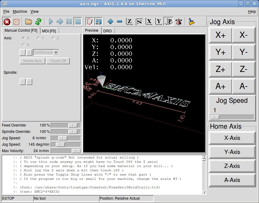

I have been trying to customize my display and have added Jog and Home buttons.
I would like to have a second Jog Slider for The A (rotary) Axis
That I can set from 1-1500 that would control only the A axis
(Similar to the Second Jog speed Slider on the main screen.)
Is this possible?
I also have added individual Home buttons but would like to have
a Home All button that would home all of the axis with a single button.
Can this be done?
I am not using any home switches and as it is now when I push the home button
it sets the axis to 0.0 is there a way to instead tell it to go home (ex g00 x0.0)?
Thank you

05 Dec 2011 13:18 #15403 by BigJohnT
Can this be done?
You can only have a home all button when you have home switches and home sequence set up for all the axis.
www.linuxcnc.org/docview/html/config_ini_config.html#sub:[AXIS]-section
John

05 Dec 2011 14:39 #15407 by andypugh
it sets the axis to 0.0 is there a way to instead tell it to go home (ex g00 x0.0)?-
Not really, as without home switches, how is EMC2 meant to know where home is?
Or do you mean "go to (0,0,0) in the current (possibly offset) coordinate system" ? In that case you can do it with an MDI_COMMAND
www.linuxcnc.org/docview/html/gui_halui.html#sub:MDI
05 Dec 2011 14:46 #15408 by Harry_Y
andypugh wrote:
Yes, since Home pretty much changes for what I'm doing
(probably not the best but for me it is the easiest).
At the start of the job I tell the machine where "Home" 0,0,0 is
then all cuts are referenced from that point.
