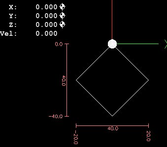

Based on this picture :
linuxcnc.org/docs/2.4/html/polar02.png
Can I clear the white line with G-Code or M Command?
- ArcEye
- Posts: 24
- Thank you received: 758
24 Jan 2012 17:53 - 24 Jan 2012 17:59 #17099
by ArcEye
Replied by ArcEye on topic Re:Python Version On AXIS
No, why would you want to, that white line is the projected path based upon the g code file that has been loaded
For instance
will result in this (very similar to your picture)
What you can clear is the yellow trace from jogging, homing, MDI moves and the red trace from running the program.
For instance
G17 G21 G8 G40 G49
G80
G90 G94
F150 S800
M3
M8
G00 X0 Y0 Z20
G00 Z2
G01 Z-0.5
G01 X20 Y-20
G01 X0 Y-40
G01 X-20 Y-20
G01 X0 Y0
M5
M9
M2
Last edit: 24 Jan 2012 17:59 by ArcEye.

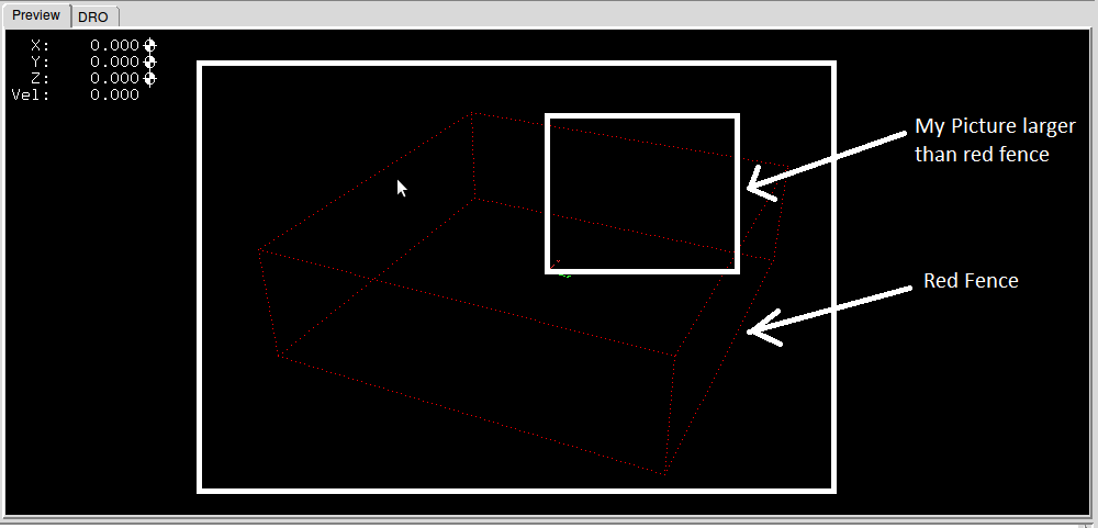

Replied by grokhehe on topic Re:Python Version On AXIS
- dab77
- Posts: 194
26 Jan 2012 22:38 #17174
by dab77
Replied by dab77 on topic Re:Python Version On AXIS
The red fence is there because remarks the limits of your machine. if your limits are correctly set into your .ini file [JOINTS] section, then your file shouldn't be bigger than that.
- grokhehe
- Posts: 13
27 Jan 2012 08:13 #17179
by grokhehe
Thx for the reply,
But what I mean is can I make rthe red fence bigger by setting in axis / .ini file ?
