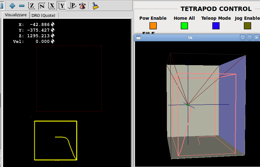

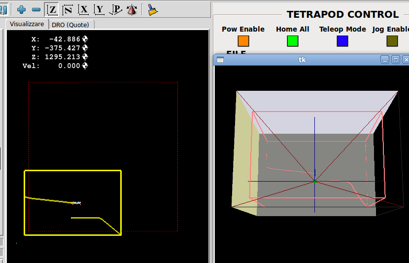

Hi.
Into the axis drawing, the red-dotted lines show the machine limits 'box'.
I guess these dimensions are taken from the .ini file, under axis (joints) sections.
i'm using JA3 branch, but before thinking of a related to JA3 issue, i wanted to ask if the same issue is present also in L.CNC 2.4 or 2.5, with non trivial kinematics.
my issue is:
-My machine have non-trivial kins.
-My home positions are offset because of my home needs.
-Whatever g-code movement of my machine is outside the machine limits. the same visually, into the axis window.
-But when i Manual-Jog Axes limits are perfectly respected.
I remember i had this issue also using what was EMC 2.4.3 or .6 , but confirmation are welcome.
Is there anyway of modifying this?
Z view:
Last edit: 26 Jan 2012 16:02 by dab77.

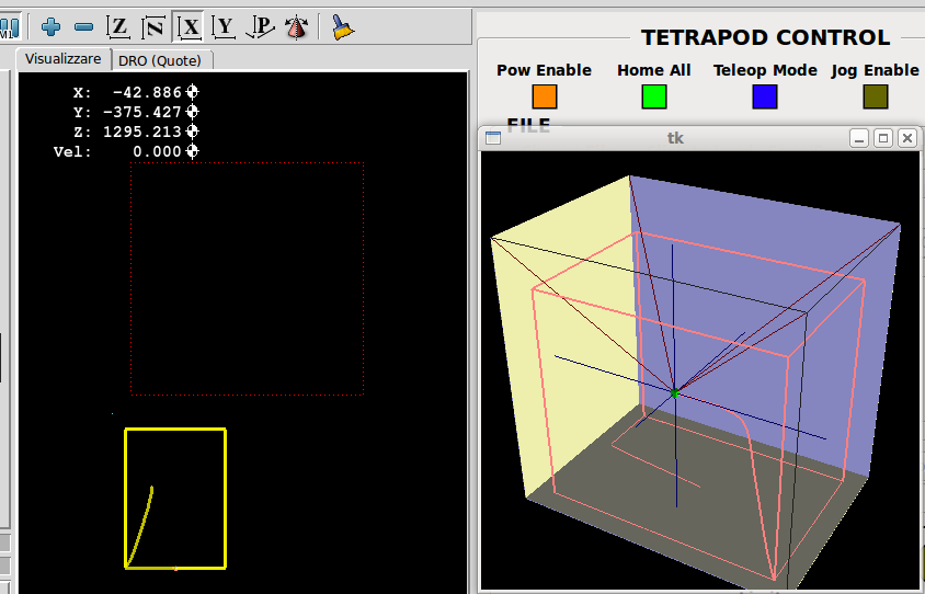

Replied by dab77 on topic Re:about the machine limit lines
X view:
Last edit: 26 Jan 2012 16:03 by dab77.

the 'room' is (mm) X=2800, Y=2000, Z=2450 , and left-bottom corner is 0,0,0.
but the offset put the 0,0,0 position at the middle of the floor.
limits are set at 200mm from each wall, 0 from floor and 250mm from top.
I really don't understand which dimension is the red-dotted-box.
Davide.

27 Jan 2012 13:13 #17183 by andypugh
Replied by andypugh on topic Re:about the machine limit lines
It is possible that Axis simply plots the joint limits as spatial limits, without going through the kins to convert to world space.
I have tried looking through the code, but it isn't easy for me to follow.

dab77 wrote:
can you tell me which file is involved?
I think it is all of them. It looks like it anyway.
I guess the actual lines are drawn in glcanon.py
