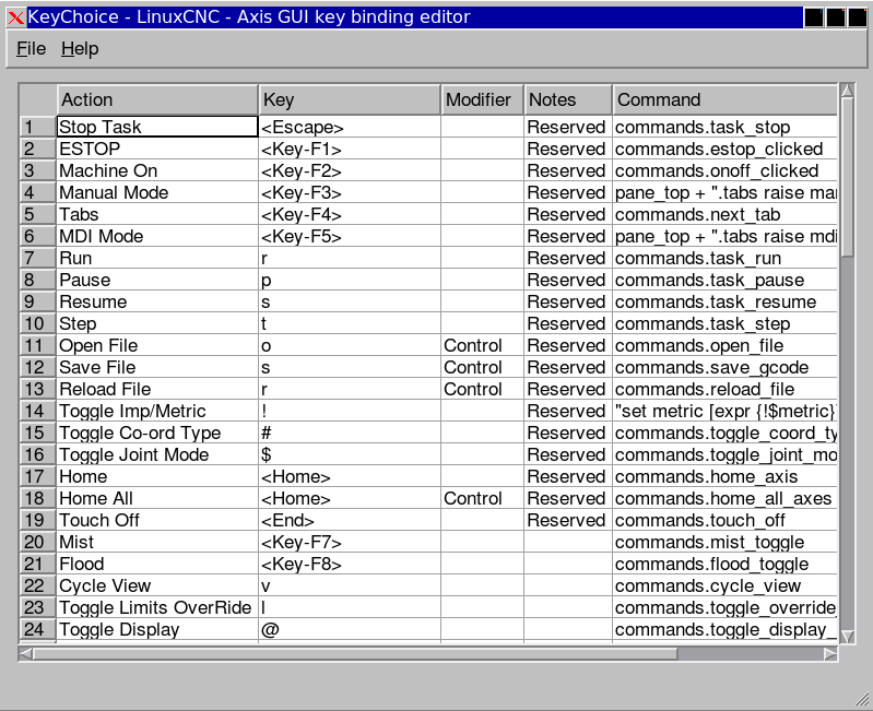

Hi
Originally from this thread
www.linuxcnc.org/index.php/english/compo...562&limit=6&start=12
I was looking a the feasibility of a menu based GUI, which allowed assignment and re-assignment of key combinations.
Some would probably need to be reserved, but a lot are up for grabs.
So I wrote one and it seems to work OK.
You can add extra commands as well as keys, but you will need to make them commands that Axis will understand and in the same format as the commands column
( with the root_window.bind() bit stripped, because the editor adds this in)
I have reserved the most universal key-bindings. They are so commonly used that to make them replaceable is potentially dangerous.
What if [Esc] doesn't halt the current task, are you going to guess what does before the tool collides with the chuck!?
It is written in QT3, so you will need to install the libraries first
sudo apt-get install libqt3-mt
Then from wherever you extracted the keychoice_0.1-2_i386.deb to, run
sudo dpkg -i keychoice_0.1-2_i386.deb
That's it, if its of use enjoy, I just wrote it to explore Axis a bit deeper and keep my hand in with QT.

25 Aug 2012 09:34 - 03 Sep 2012 13:11 #23651 by ArcEye
Replied by ArcEye on topic Re:KeyChoice - Axis Key-Binding editor
bjames28 wrote:
It's amazing ! Really cool tool. Works perfectly.
Many thanks ArcEye.
You are welcome - thanks for the feedback.
I have now sorted the Qt libraries issue.
Ubuntu just builds and links against the threaded Qt libraries, but the default build of Qt is non-threaded.
Even when you build the threaded libraries, qmake's default is to link against non-threaded.
I recently re-built Qt3 for development, but because I have every library under the sun installed, I missed that it was linking against non-threaded libs, as it worked.
The new deb has been tested installing on 8.04 and 10.04
Instructions are the same
You will need to install the libraries first
regards
