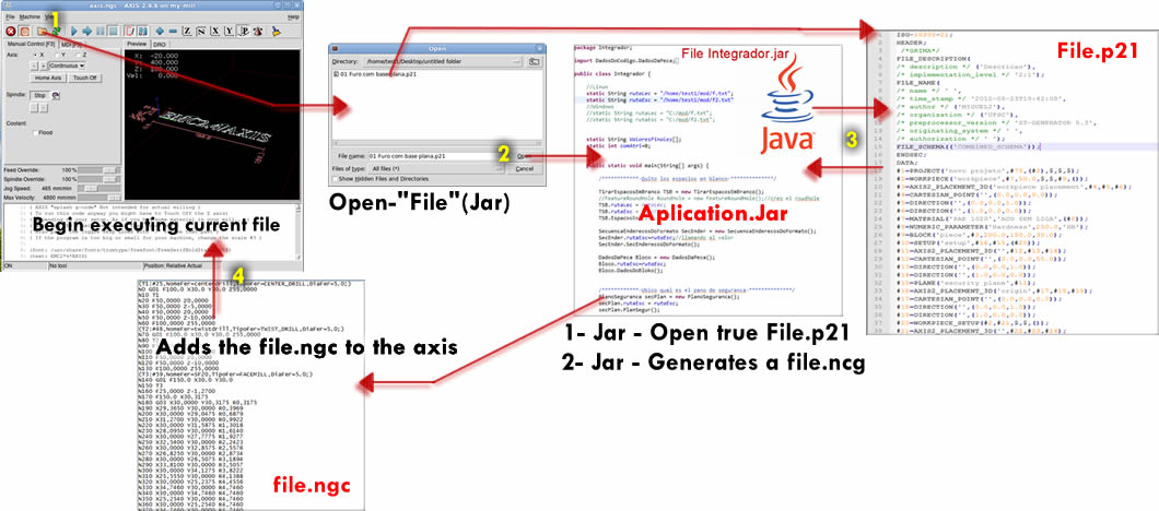

can someone help me?
I do not know much English but I wonder if you can help me with something.
I have a program that adapts a p21 file to g-code, my program is in java (. jar)
my program works:
the input file is a file StepNc (ISO14649 AP21) = file.p21
output file = file.ngc
my problem is:
I want that when open a file with the gui-axis, the axis that passes the file.p21 to my java program and run the program, and the output of java program, is the axis of the input file
or is there another way?
Annex a picture to better explain
my program works:
my problem is:

Add your java program as a filter to Axis.
linuxcnc.org/docs/html/config/ini_config...sub_filter_section_a
