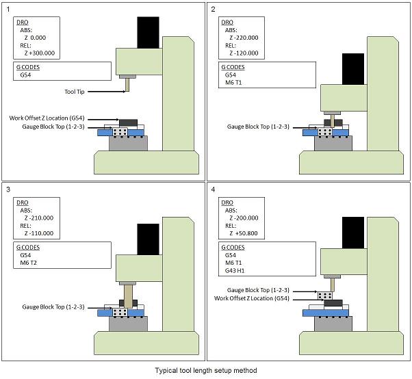

The method used by most industrial controls (Fanuc, Haas, Fadal, etc.):
1) A tool is loaded into the machine (M6 T1) in MDI mode or using a built in utility.
2) That tool is jogged to some know location on the machine (usually a sliding gauge block or tool length probe). Using the tool table in the control, the active tool is selected, and a measure command is used to record the current ABSOLUTE Z axis position which is then entered as the tool length by the control (you can then add in the height of the gauge being used if you like). Tool 1 would have a "length" of -220 according to the figure.
3) Additional tools are added using the same method at the same gauge location. Tool 2 would have a "length" of -210 according to the figure.
4) After the tools are set, one tool is chosen to set the work offsets by "touching off" (any tool will work as long as its length offset is active).
(See included figure)

22 Apr 2010 22:04 #2654 by ewlsey
Replied by ewlsey on topic Re:Tool Length Offsets in EMC
Figure

You can do it either way in Axis. I touch off all my tools a known distance from the spindle face so I can add or change tools to my turret at will. All you have to do is make sure no offsets are in effect when you set up your tools.

I don't know of anyway in EMC to work without an active offset. G53 can move in absolute units, but does not allow you do anything else. On some controls G53 cancels the work offset and is modal, EMC is not set up like this.
You always work with an active offset but when setting the tool table you want it to be equal to the machine coordinate system.
linuxcnc.org/docs/2.4/html/gcode_main.ht...:G10:-Set-Coordinate
and yes all controls are different and no one control follows any standard past G0 and perhaps G1 on some controls.
The beauty of EMC2 is you can change to to be anything you like by downloading the source code and modifying it to be like the control your familiar with.

My current method to do this is to use one of the work offsets for tool setting only (G59.3). This code might do it:
Set up tool table:
G10 L2 P9 X0 Z0 Y0 (set G59.3 to machine 0)
G59.3 (activate G59.3)
M6 T1 (load tool 1)
#Touch off tool table in Axis for each tool being loaded
Then to set the work offset (using tool 1 to touch off the work offset):
G54 (activate G54)
M6 T1 (load tool 1)
G43 H1 (activate tool length offset for tool 1)
#Touch off to G54 in Axis
That gets me where I want to be. It would be better if I could do this without losing one of my work offsets and if I didn't have to remember to activate G59.3 when setting tools. Maybe I am just lazy.
