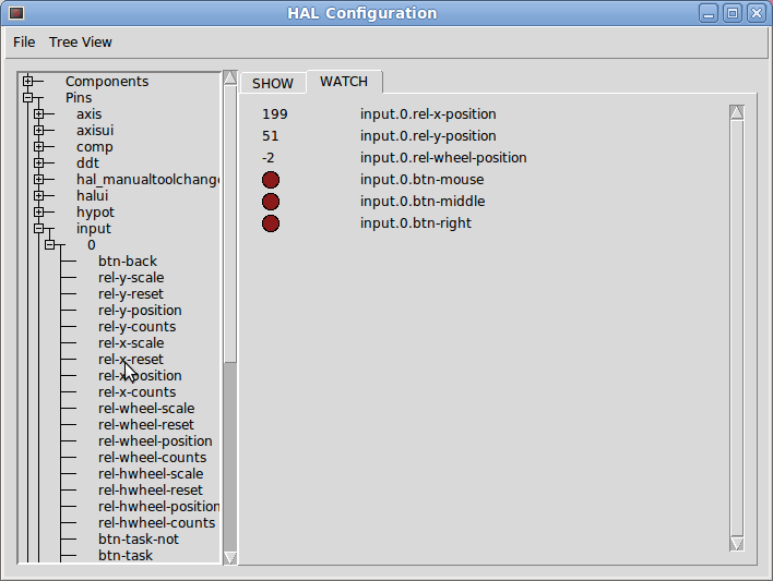

Hi!
I am sorry for this novice-like question. I sure that Adult Machinists never thinks about it and possibly hates it. I know that there is many levels of translation and matematics between top-level controls (G-code, Axis, etc) and lowest level LPT port pin change. But maybe it is possible to go through all these levels and have the possibility in AXIS to generate individual steps (output STEP pin pulses and DIR control for currently selected axis via Axis interface) using say mouse scroll wheel in Axis ?
Or i need to ensure that is absolutely impossible at all now and in far future.
I also remember questions here about similar things (direct user control of stepgens) years ago, but today can't find anything related.
Thank you so much!
Thank you so much!

treat the mouse as a Quadrature encoder , and then use Hal directly as if your using a Handwheel encoder jog .

Look at the pins axis.N.jog-counts, axis.N.jog-enable and axis.N.jog-scale here:
www.linuxcnc.org/docs/html/man/man9/motion.9.html
Replied by andypugh on topic Movement for atomic step(s) by mouse scroll wheel?
i can only control velocity of jog, not the position.

It works exactly as i need! Thanks!
btw, i write (simplest possible) example howto for using 2nd mouse as controller (move as X, Y control and scroll wheel as Z control). While it is not exactly what i looking for, but it is good intermediate result, is looks useful somewhere, and good learning example and starting point for me to get what i want, if it is possible at all.
So here's the howto. It based on clean install of LinuxCNC running in simulation mode, mm units.

Go to Machine - Show HAL configuration.
Select WATCH at right.
Select at the left, Pins - Input - 0 - your_suspect_parameter (like 'rel-wheel-pos' etc.). It will be added to watch. (PICTURE 1)
Scholl/move 2nd mouse and see if parameter changes. If not, there is problem somewhere, can't continue.
Close HAL window.

Replied by jpka on topic Movement for atomic step(s) by mouse scroll wheel?
Pictures
