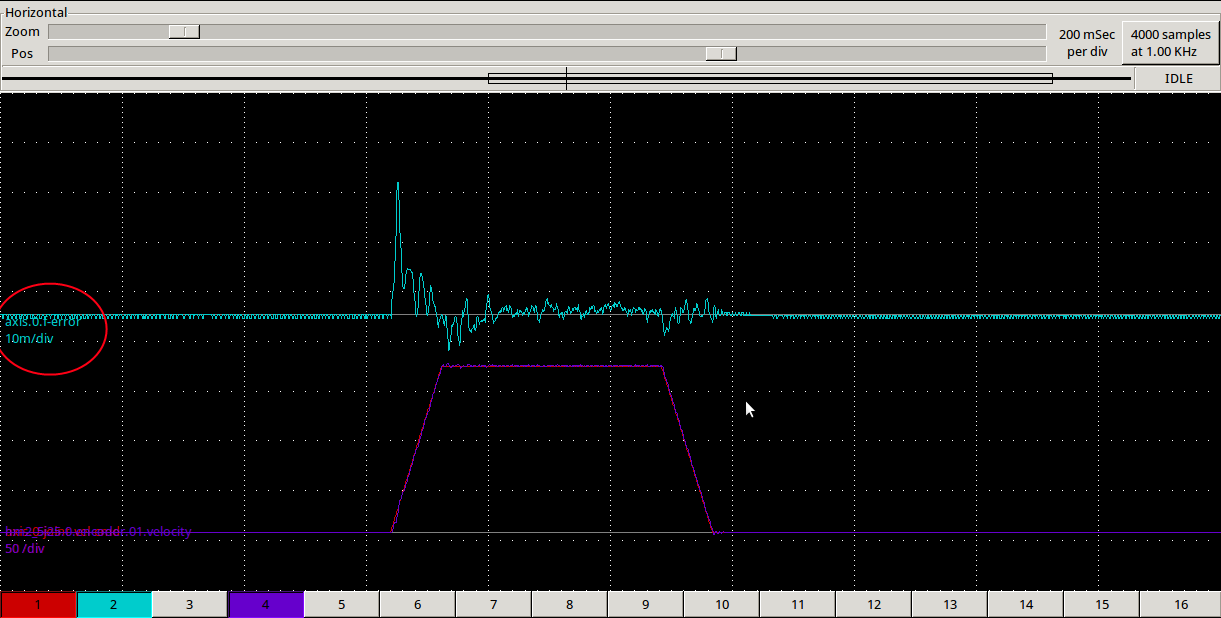

Using the recommendation of PCW we were not able to get a proper working system. Please take a look below for what we had and was working:
and using the PCW recommendation we changed to (only changes are present, the others are the same):
We have immediate following error.
Is the following error in velocity mode, positions or velocity?

One more note: what is the time per division? its clipped off in the halscope images
there seems to be significant delay between the command and the start of motion
this may indicate a tuning issue in the drives (command input filter for example)

19 Dec 2013 15:54 #41816
by emcPT
My mistake, when I wrote, I was not on the machine and I had to myself that the values started at 1, so FF1 FF2 and FF3. They were really FF0, FF1 and FF2.
With more tunning, we ended up in using:
P=65
I=2.5 (in one axis) the other 0.7
D=0.2
FF1=0.59
FF2=0.004 (in one axis) the other 0.002
This improved the response and now we have max peck of 1/3 in relation with the previous results AND the actual position on the DRO is near the commanded position as the ferror stationary is near 0.001 mm.
200mSec.
This was quite a nice tip! I am almost sure that the drive input filter is on. Will check it.

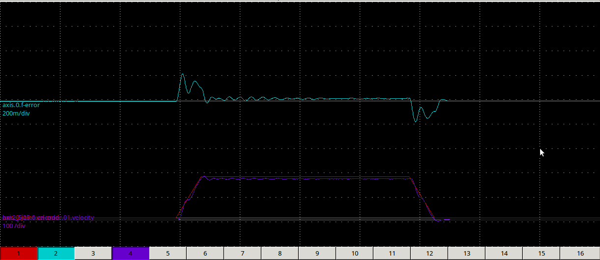

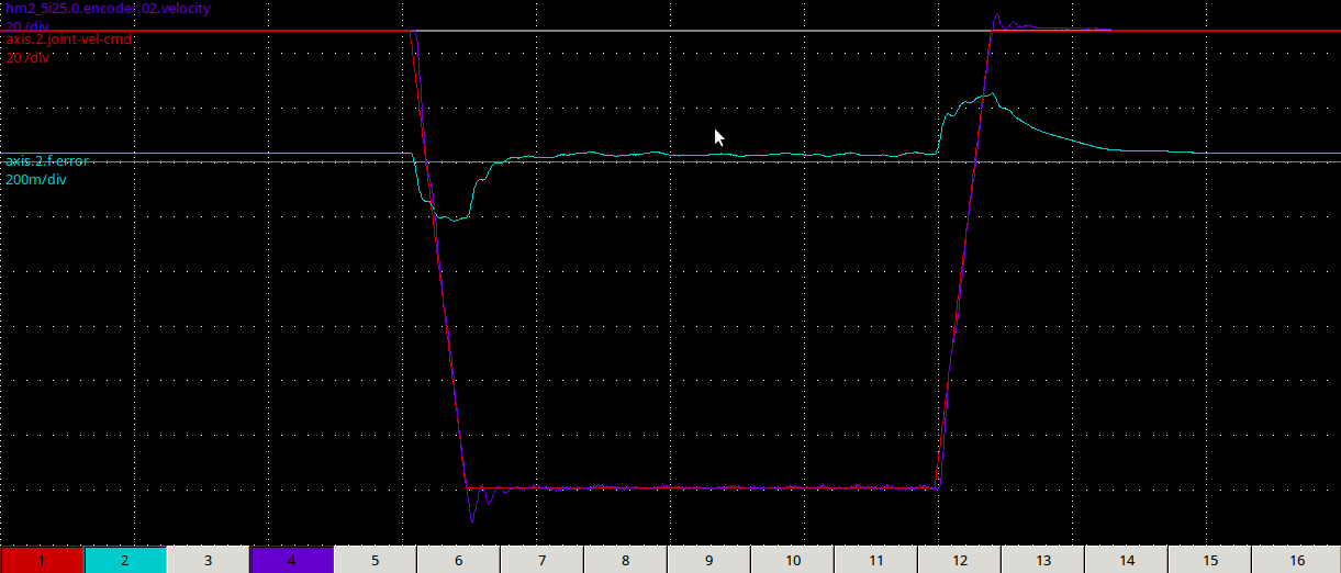

19 Dec 2013 21:26 #41830
by emcPT
Replied by emcPT on topic touch off don't zero the axis
Done!
The input filter on the drive was making a large difference. We had to readjust all, and the ferror now is minimal. We have the graphs attached!
Thank you. Again.
