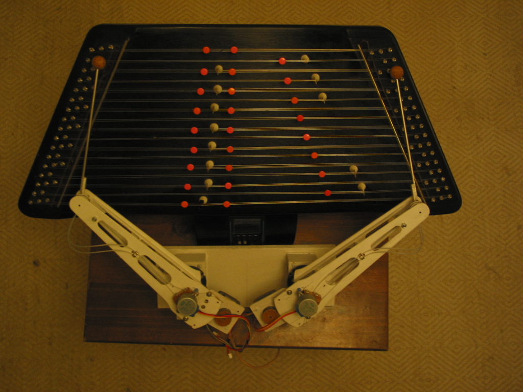

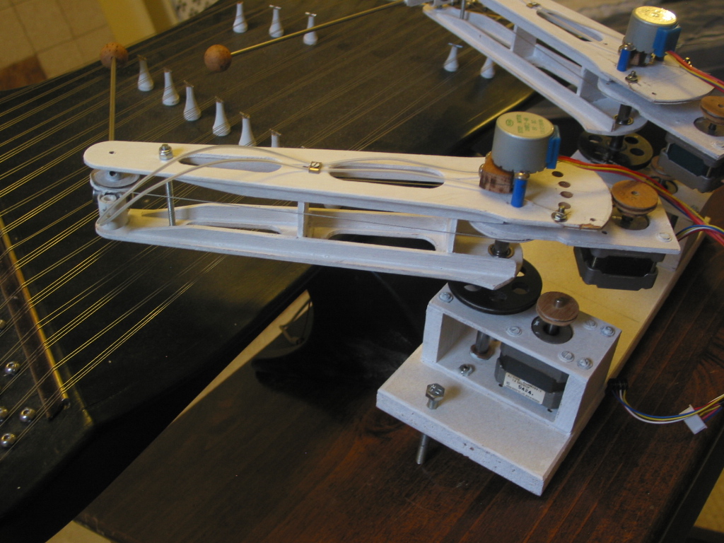

Finishing the last drive wires tonight, but herewith a couple of photos to give some reality to what I'm trying to do.
Please let me know if you need any explanation of what the photos show.
Close up of one of the arms. The lowest stepper swings the whole assembly horizontally. The next one, drives the inboard end of the arm, which is geared to the outer arm (the hammer) with a 2:1 drive with the result that the tip of the hammer arm moves in a straight line.
The upper small stepper controls only the vertical movement of the hammer arm.
The second photo shows the overall arrangement with the dulcimer( needs re-stringing ! ), with a red disc showing the striking positions.
By this you can see that there are only a limited number of positions that the hammers are needed to go to, and the 'resolution' is pretty low - of the order of +/- 2mm !
John

I suspect that writing a "dulcimerkins" for that system might be more trouble than it is worth.
It would probably suffice to define an O-word sub for each striking position that simply moved the hammers to the required (expermintally determined) points.
Having said that, the kinematics is probably fairly straightforward. You basically need to modify scarakins to handle 4 more joints:
git.linuxcnc.org/gitweb?p=linuxcnc.git;a...56bda9ab526e;hb=HEAD

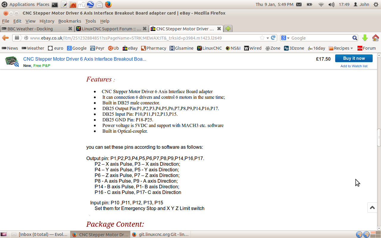

I have just spotted a six axis breakout board on ebay, and combined with the driver boards I already have , perhaps I would have at least the hardware sorted ?
Thanks Andy.

I have frequently not bothered with breakout boards at all. You can typically wire stepper drives directly to the parallel port. There is some risk, but it is fairly small.
Parallel ports typically sink more current than they can source, so with a typical stepper drive with opto-issolated inputs the wiring is +5V to the input+, then wire the input- to the parallel port. Then when the p-port is 0 the current flows from the +5V line, through the opto, triggering the step, and then back into the parport to GND. When the parport is 1 then there is no voltage difference between the two sides of the opto, and no current flows.
Wiring this way does require that the parallel port pins are set up inverted, so "step" = 0 and "space" = 1. This is a tick-box against each pin in stepconf.
Replied by andypugh on topic Need to run two 3-axis stepper controlled arms
