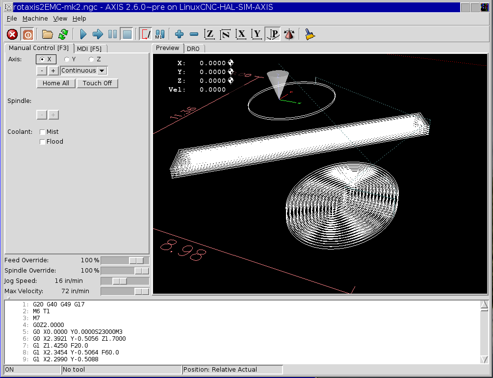

30 Jan 2014 17:15 - 30 Jan 2014 23:08 #43324
by ArcEye
Replied by ArcEye on topic Rotary Axis setup in LInux Axis
Hi
You have only attached one file.
I don't know if it is in native vcarve output or has been put through a postprocessor, in which case which one?
Whatever, aside from a couple of stylistic peculiarities (doing a toolchange before even defining which planes the machine works in for one) it is a basic g code file for XYZ
I have made a couple of alterations and spaced the co-ordinates so that it can be read more easily.
(I hate CAM output, it is like trying to read an email from a semi-literate, grammatically challenged child.)
The resultant file loads OK as per screen shot, I presume this is what you were expecting?
I have downloaded your zip and will look at it later
Now need the output from vcarve itself, if that was not it and a link to whatever post processor you used, if you did.
The amended g code attached below

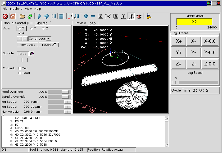

30 Jan 2014 20:04 - 30 Jan 2014 20:05 #43330
by ArcEye
Hi
Now had a chance to look at the configs you attached.
The setup does not use the A axis, it runs Y2 in tandem with Y1 via a complex series of logic components that I won't go into
Adding an A axis which is an angular one, is thus simple.
I removed all home and limit switch inputs and jury rigged estop, to create a simulator and here is your setup with an A axis running the same code you posted.
This however is just the start.
I have no idea what 4th axis you are going to use, what stepper controller timings, what the scale of it is, whether there will be a home switch etc etc
I have just guessed some figures to make it work in simulation, which are unlikely to match what you physically will have.
So over to you, in addition to the outstanding info re the g code output, now need to know all about the 4th axis and how it will be connected
regards

30 Jan 2014 22:20 - 30 Jan 2014 22:39 #43332
by ArcEye
As per my previous, there is already a config on the Probotix site for use with their 4th axis
www.probotix.com/wiki/index.php/File:Meteor_4th_Axis.zip
It bears striking resemblance to the one I made
Copy your whole config across to another folder and replace the .hal and .ini files with these
regards
