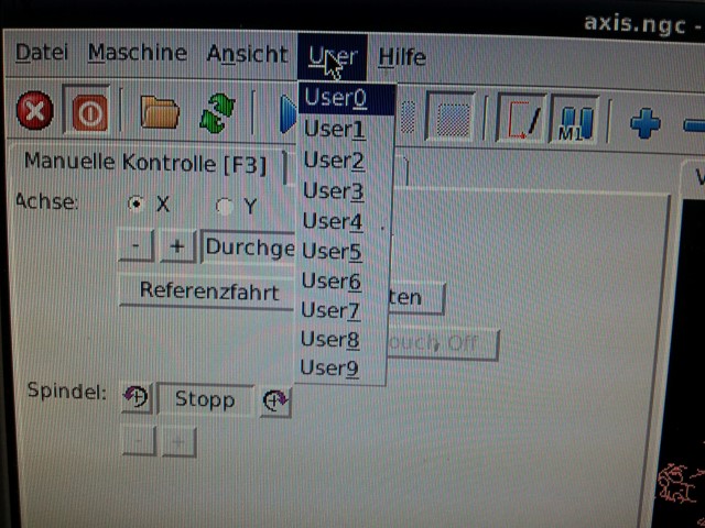

- Tchefter
- Posts: 197
- Thank you received: 34
28 Jan 2018 10:58 #105104
by Tchefter
Replied by Tchefter on topic Axis - user defined keys
Hi, does this procedure have to be applied to version 2.7.11?
I need some User Commands, but it seems its not so easy for a noob...
Regards Fritz
Regards Fritz

04 Feb 2018 14:56 - 04 Feb 2018 14:56 #105405
by Tchefter
Last edit: 04 Feb 2018 14:56 by Tchefter.
- Posts: 19902
23 Feb 2018 17:44 #106405
ArcEye posted the original message in 2014. I don't think he hangs out here any more.
Replied by andypugh on topic Axis - user defined keys
Well, I did it, it works. Perfect! Thanks for not responding to my question,
- Tchefter
- Posts: 197
23 Feb 2018 17:52 - 23 Feb 2018 17:52 #106408
by Tchefter
Yes, i know, but its helpful also in V2.7.12
Something I've already thought, that's a pity if it were so.
Regards Fritz
Regards Fritz
