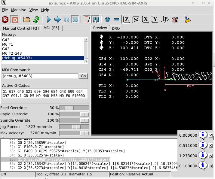

What version of Linuxcnc are you running?
- Posts: 23377
- Thank you received: 4966
03 Sep 2015 20:29 #62084
2.6.4 (as you can see in the picture).
I would be surprised to find that this has changed in 2.7, but I am not excluding the possibility.
Can you try the MDI sequence in my example and see what you get?
Replied by andypugh on topic Shown AXIS TLO Z Offset not stored in #5403 ?

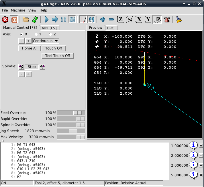

Discussing it on IRC, we think that the manual is slightly unclear.
#5403 and friends display the tool _table_ offsets of the selected tool. Independent of any transient offsets.
(Note that I confused myself above because G43 has a higher priority than G10, so the G43 loads the original tool length before the G10 changes it)

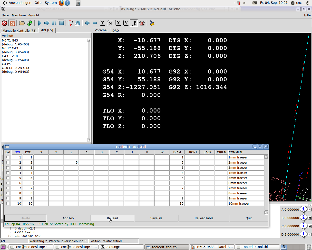

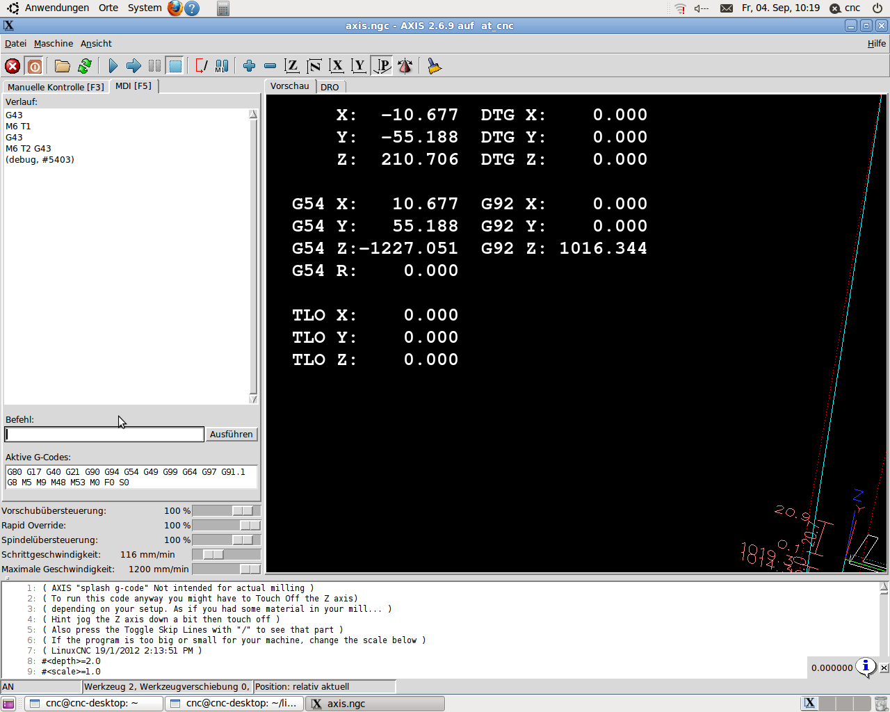

04 Sep 2015 14:14 #62111
by altihu
Replied by altihu on topic Shown AXIS TLO Z Offset not stored in #5403 ?
Meanwhile I figured out too that #5403 contains the value that ist _stored_ in the tool.tbl, like andy wrote in the last post. I my setup i am using a tool length sensor but i didn't saved the lool length offset into the tool.tbl. Tool length changes every time i change the tool due my tool holder. When I saved the G43.1 measurement - the #5403 is updated.
I dont want to save the tool length offset in the tool.tbl - but i need to check in my "tool measurement script" if there is a TLO Z (stored or not stored) because the _first_ tool has to be touched of to the surface by hand. When the display of the offsets is switched off - my script fails...
Is the _displayed_ TLO Z accessible in some other way ?
linuxcnc-version is 2.6.9
