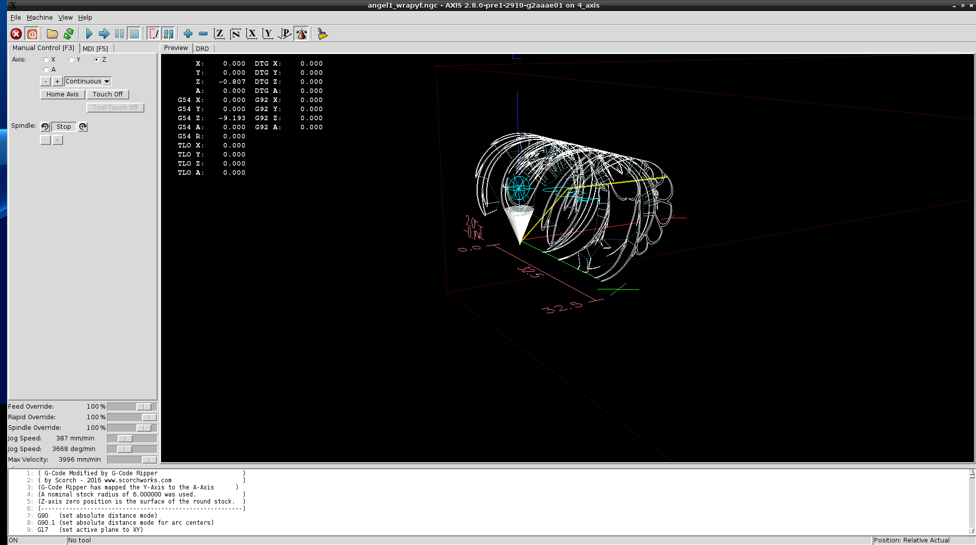

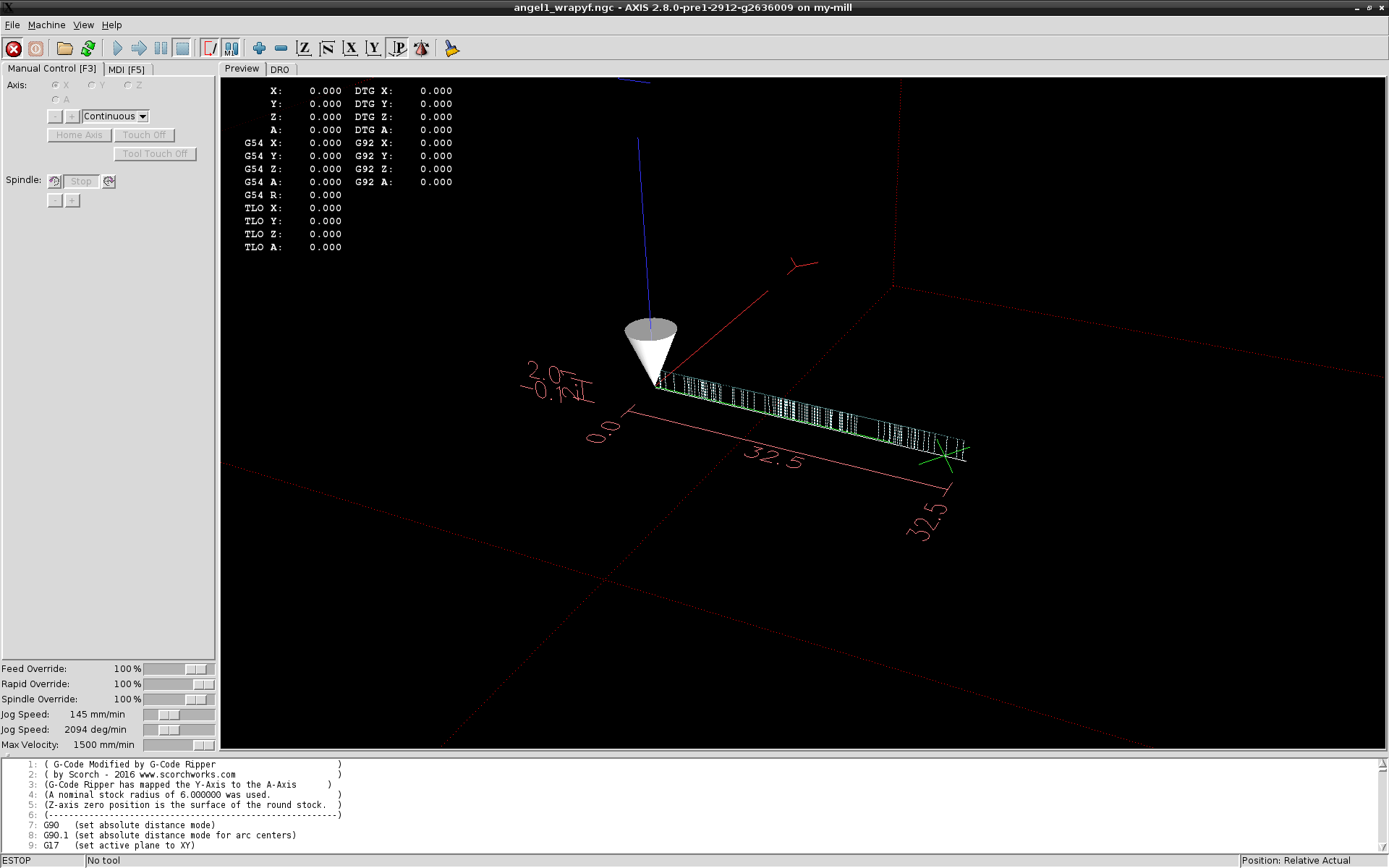

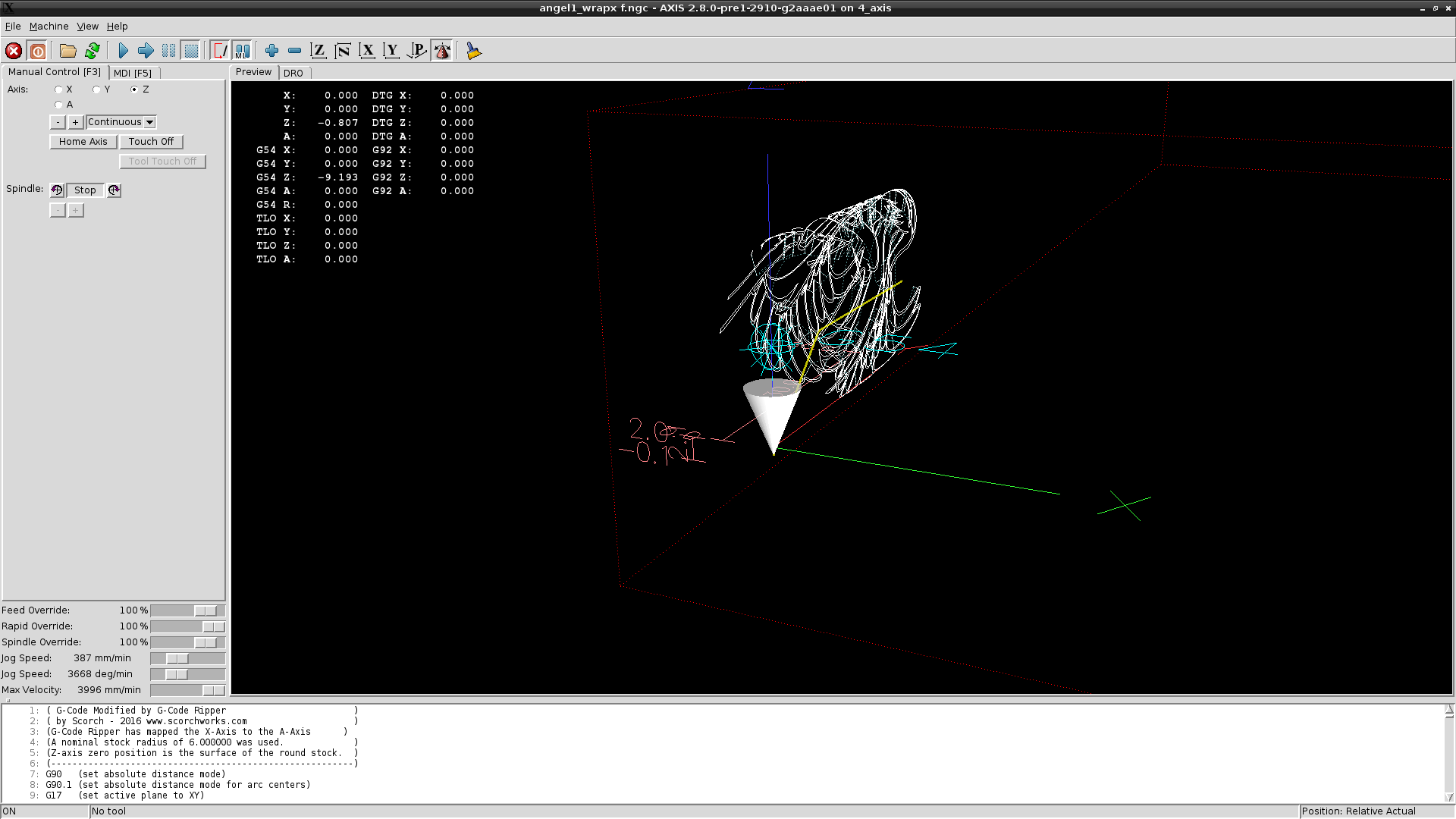

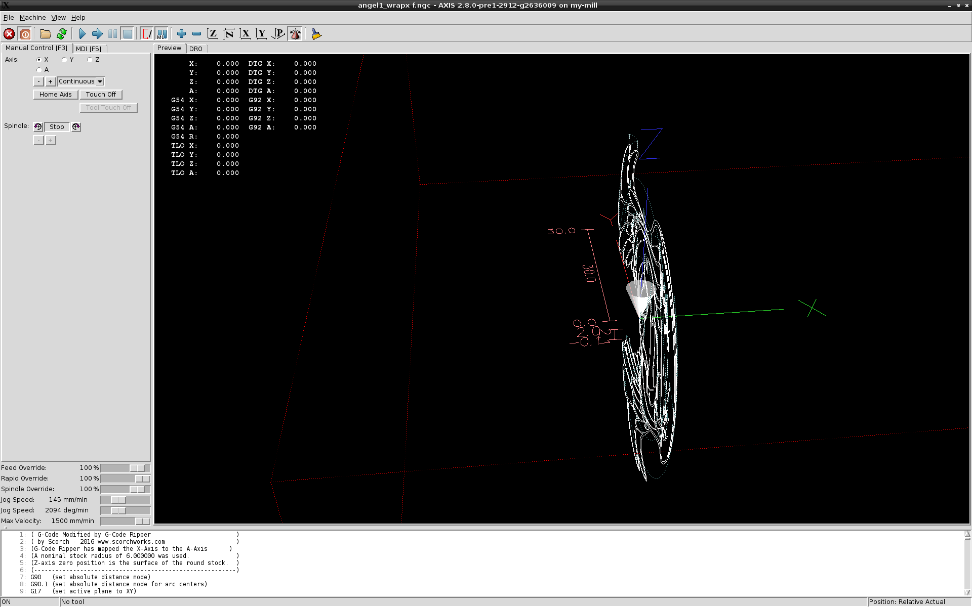

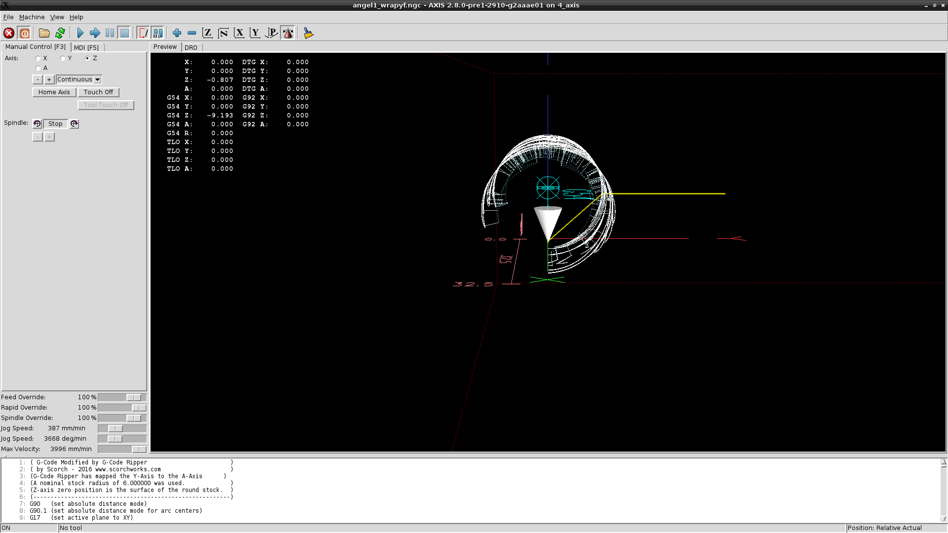

Hi guys. I am back again with the same question or problem.
By playing with the order of Geometry I can almost get what I am looking for.
Took the same ini fie to a different computer and it looks totally different
Here are the same files with the same config on a different computer, all copied and pasted from one machine to the other.
In these screenshots it looks how I would expect and is what I have been trying to achieve with a nice wrapping and showing the image.
Any suggestions as to what to do to get this right I know it can be done because It's so nearly there. The next image on the X axis is a beaut, how can I get that on the Y axis instead it showing flat.

I'm not sure why you got different results on two different computers.
I think part of the problem is your G-code. You got the effect you wanted when you wrapped X around A. If you want the same effect with Y you will need to wrap Y around B (not A).
