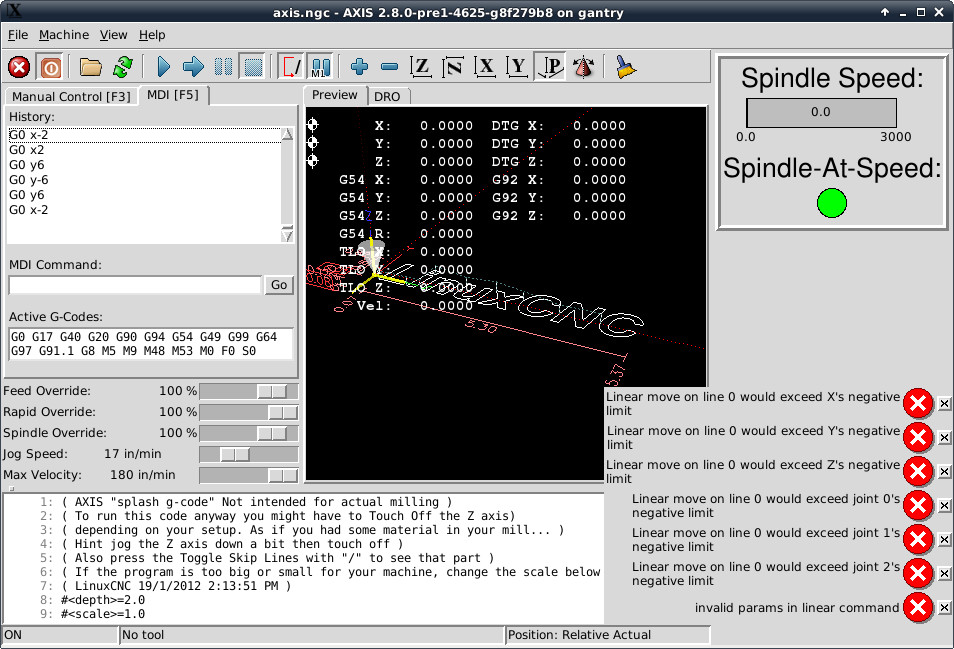

Newly converted to 2.8. When the machine is homed and I try a program it apparently sends the X axis (at least) in the wrong direction.
The Axis display also seems to show the X and Y going in the wrong direction when jogged with MDI commands.
I have a one line program that I tried and include a screen shot of the Axis window showing the program and the errors when it tries to move the X axis.
I would appreciate any help or suggestions.

Thanks once more for the suggestions on my problem. I edited the .ini file to match the original (before 2.8). Now I have a problem in that I cannot ever home the X axis so I cannot try any programs. The other two axes home with no problem.
I have tried all sorts of different numbers in the .ini for the X minimum limit and the error continues to be "Exceeded NEGATIVE soft limit (0.01000) on joint 0". I admit that I cannot even figure out where it is finding this minimum limit as I change the value and the error does not change.
I still can move the the axes with the manual control on the Axis panel so I tried an MDI command to move the Y axis and the result surprised me so much that I tried the Z axis (with the same result) and took a screen shot of that and will attach it along with the .ini file as it is now.
Again, I will welcome any suggestions.

Several issues:
X axis has a ferror of 0.01 while all other axis have 0.05
Z axis is the last to home as set by number 2 in the homing sequence, set that to 0 so it is the first to home always. The reason for that is that if the Z axis was down cutting when you press home it will start moving and break the tool on the way home.
Why are you soft limits set at 0.01 ? That is to small value, you can set it to 1 or more, it makes no difference if all your limit and home switches are at the negative side of travel.

16 Mar 2019 13:16 #128733
by norbertfarquharsh
Replied by norbertfarquharsh on topic MDI and gcode directions are reversed
Thank you very much for your help. I appreciate your suggestion on homing, too, as that is a good idea, but I adjusted the limits as you suggested and it homes just fine.
I ran a program and everything on direction works now, too.
