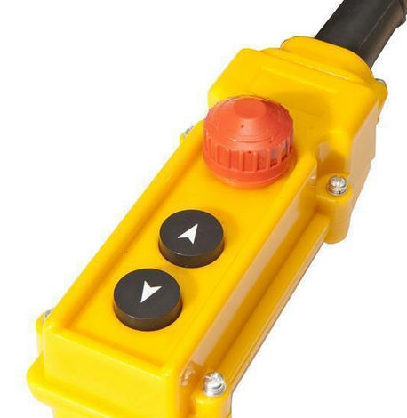

22 Apr 2019 07:07 #131465
by pl7i92
Replied by pl7i92 on topic Jogging z axis while machine is running
