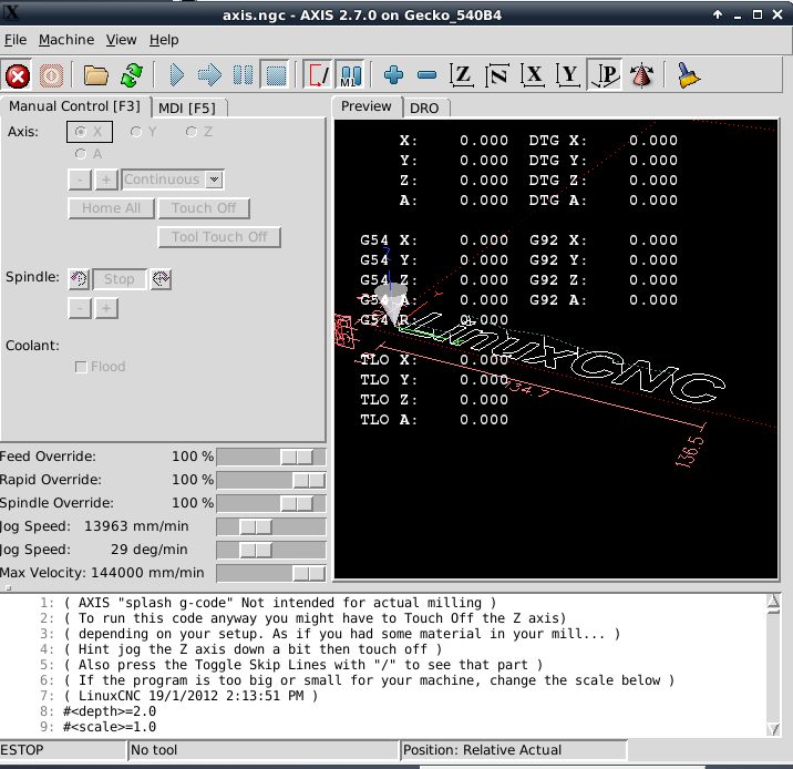

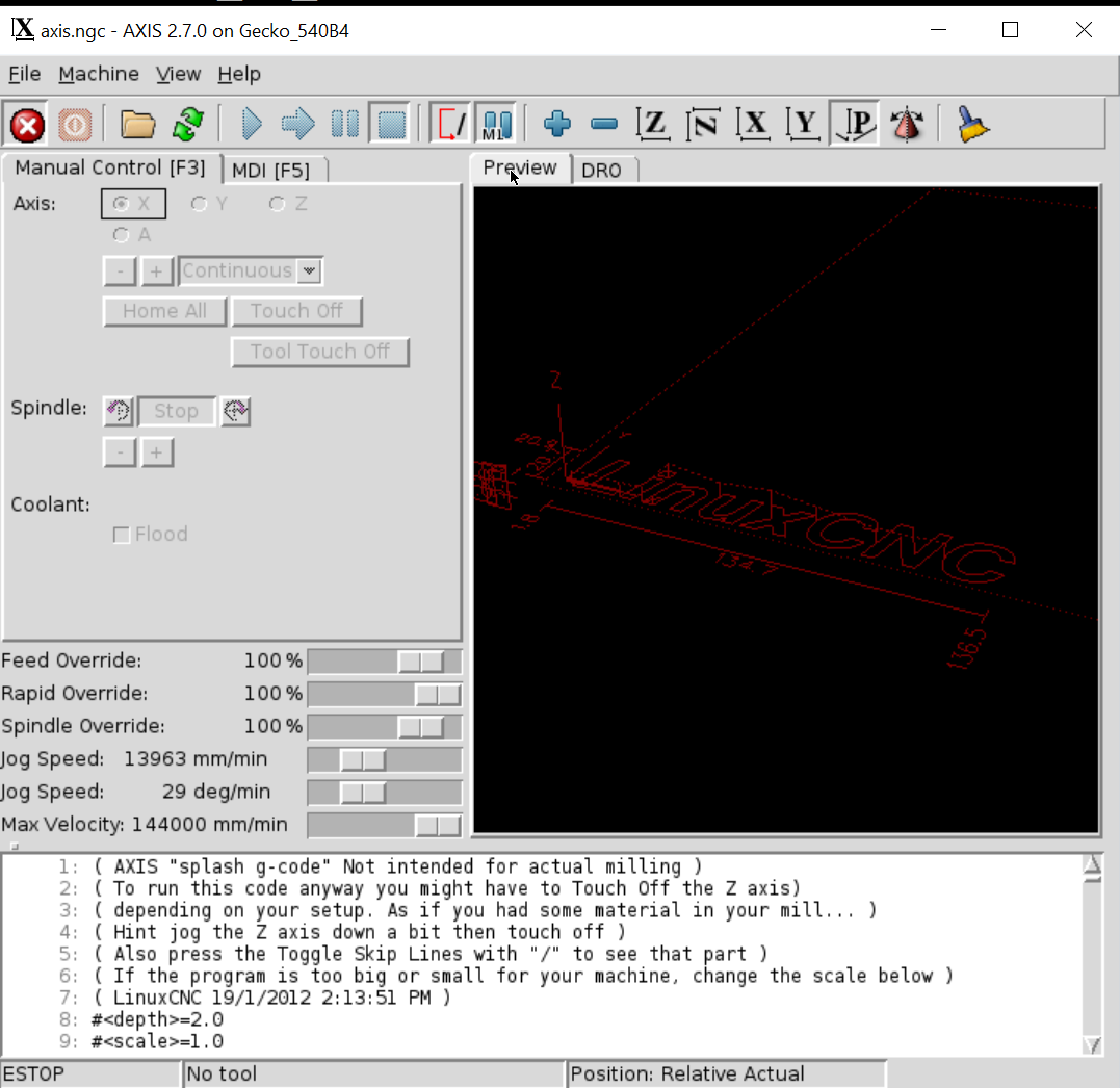

Different preview in local X11 and remote vcXsrv. Loose machine coordinates. was created by bearer
I need to use my LinuxCNC machine as headless, and have been using X11 over SSH , and for the longest time I think I messed up the configuration to loose the displayed coordinates in the preview tab.
However I just finished a clean 2.7.0 install from a fresh download, and did the setup from scratch with stepconf wizzard - same result.
(same result after updating to 2.7.14)
Suggestions on how to fix this, or better options for running the machine headless? I previsouly tried VNC but felt the performance was much better with x11.
Local X
Remote X
Local X
Remote X

Nice running are x2go or xrdp

Whoa, that was a rabbit hole to get xrdp installed on the fresh wheezy install from the live cd. Would I be better off updating to a more recent linux version by following some of the forum threads instead of the Getting started guide?
xrdp wasn't able to launch linuxcnc at all
full output below
X Error of failed request: BadWindow (invalid Window parameter)
Major opcode of failed request: 3 (X_GetWindowAttributes)
Resource id in failed request: 0xffffffff
Serial number of failed request: 653
Current serial number in output stream: 654full output below

Hmm, I use X over ssh and do not see the problem you have there
(ssh -Y This email address is being protected from spambots. You need JavaScript enabled to view it.)
It looks like a graphics rendering problem of some sort.
What OS is the "viewing" PC running? Also Linux, at a guess?

Sorry should have included that information!
Windows 10, putty/plink and VcXsrv.
This keeps repeating in the ssh window, so I presume its tryring to update the coordinates, but fails for some reason.
error: (1280, 'invalid enumerant')
