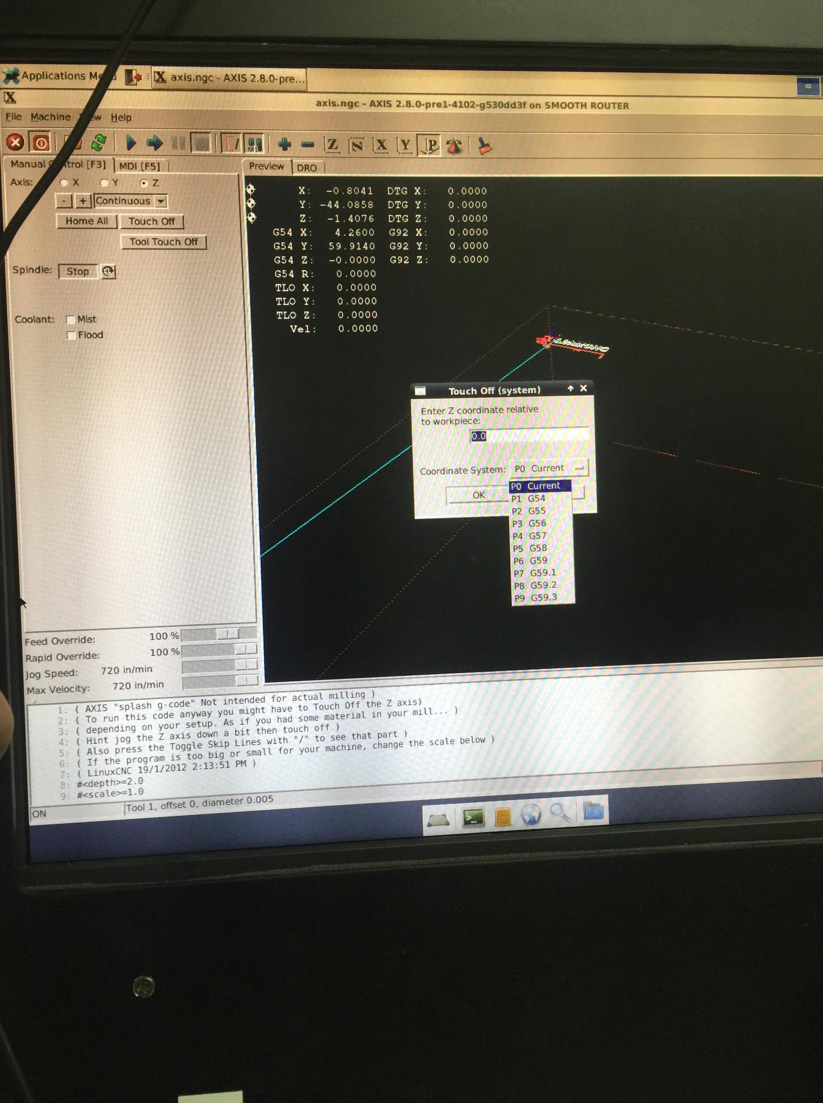

hello all, im new the linux cnc world and was wondering if anyone has some advice for me. we a running axis 2.8.0 right now on a thermwood router and we are having an issue touching off our tools. We are currently touching each tool off the workpiece individually every time we make run a part. we are looking to touch all tools off to our work table and use the work offset on the tool table, any imput of videos will help! thanks you

So as i am trying to follow the steps your link provided me ive come across another issue, im not sure if it something that i did or it is our system but i have not option in my drop down menu for (t tool table). i attached a photo as well.
Manual tool change put the tool in the spindle and do a Tn M6 G43 where n is the tool number in the MDI window.
Tool changer just do a Tn M6 G43 in the MDI tab to load the tool.
Verify that Machine > Touch off to fixture is selected.
Jog the tool to the fixture point and using the dowel method position the Z end of the tool.
Verify that the Z axis radio button is the selected axis in the Manual Control Tab
Press the Touch Off button and select T Tool Table from the drop down list box for Coordinate System.
Leave the number at 0.0 and press OK

To touch off a tool in 2.8 you click on Tool Touch Off, I need to update that tutorial, I think I did that around 2.4 or so.

It was too easy to forget to select "T for tool" and end up messing up all the offsets, so a separate tool button was added.
