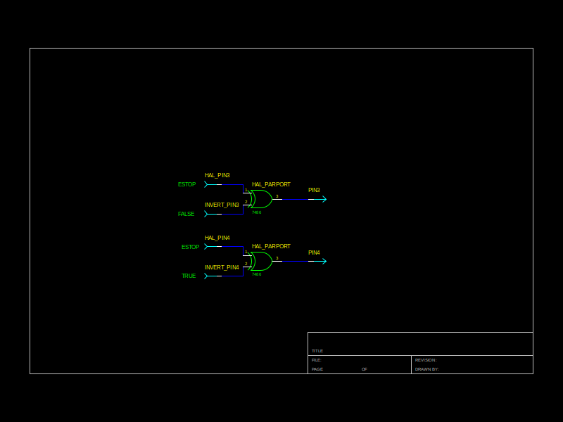

In my .hal file:
#create a signal and connect to parport pin for estop activated for Estop-on (red) ind
net estopactivated halui.estop.is-activated parport.1.pin-03-out
# now create a signal for estop not activated for Estop-off ind (grn) & motor control
net estopactivated => parport.1.pin-04-out
setp parport.1.pin-04-out-invert true
Therefor I would believe that pins 3 and 4 should be opposite of each other.
However,
Upon start of Axis and into Hal Configuration/Watch I see parport.1.pin-03 "on" while actual pin is 0 volts - means Estop activated
at same time I see parport.1.pin-04 "on" while actual pin is 4.7 volts - means Estop not activated.
How can this be? Those signals on pins 3 and 4 should be opposite of each other, shouldn't they?

I think that's correct, the output state of the hal parallel port pin is
whatever you set it to, but the actual physical output pin polarity
can be true or inverted depending on the state of the out-invert parameter.

But shouldn't pin 3 and 4 always be opposite of each other with the given Hal statements?
Hal Show indicates true on both pins simultaneously. How is this possible?
My goal is to have a Red indicator when Estop is activated and a Green indicator when Estop is inactivated. They can't both be lit simultaneously.

You wrote above:
Pin 3 for estop on
Pin 4 for estop off
Pin 4 inverted true.
That makes the both act the same.
Remove invert.

Yes its possible because the inversion only affects the output state, not the hal pin, Something like this:
Replied by PCW on topic Hal Show not agreeing with parallel port signals

I don't understand the diagram. The 7416 shown is listed as a hex inverter gate. You are using a logic symbol for a nor gate. Very confusing to me. Could you explain further and or add a truth table?
Also is a Hal parallel port pin different from the actual parallel port pin? That would kind of make sense to me because as I see it, Hal is telling the parallel port card what to do but does not really know what the parallel card is actually doing. Somewhat like a driver telling a stepper motor to do a step but the driver doesn't know if the motor obeyed the command.

The gate/symbol is an exclusive or gate (its a 7486 but the conversion to png lost some details)
Its truth table is as follows:
Note that when IN1 is 0, the output follows IN2 but when IN1 is 1, the output is the logical inversion of IN2
So the driver hal pin reflects what it has been set it to in hal but at the actual physical pin
the output can be a true or inverted copy of the hal pin based on the invert option.
Some other hardware allows what you are suggesting but is does it by having two hal pins per
physical pin, an input and and an output pin, where the output pin reflects the hal pin state and
the input pin reflects the actual read back state of the physical pin.
in1 in2 out
0 0 0
0 1 1
1 0 1
1 1 0Note that when IN1 is 0, the output follows IN2 but when IN1 is 1, the output is the logical inversion of IN2
