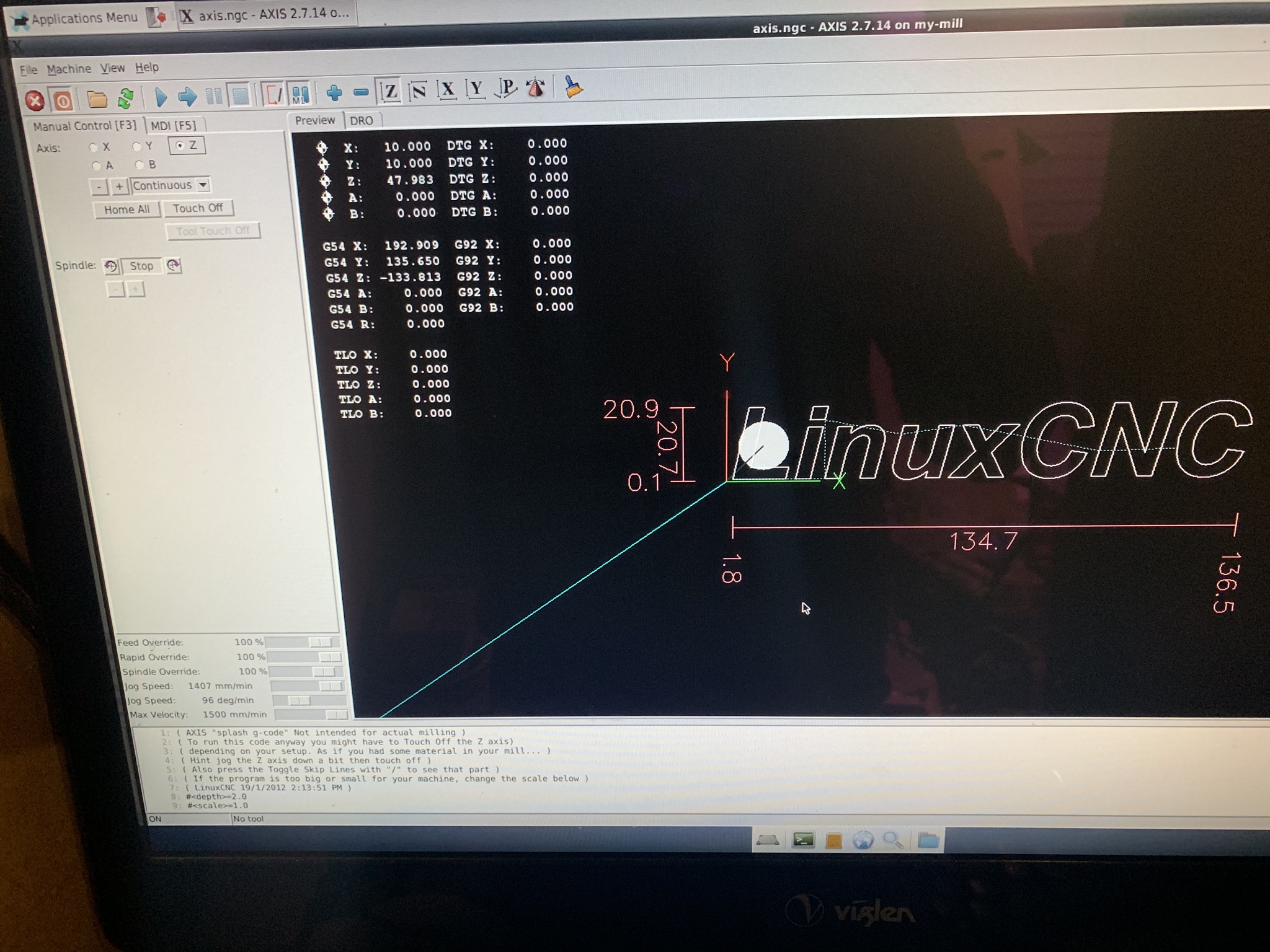

hello everyone,
i've managed to set up all the axis and homing directions okay and tested the repeatability with a clock while jogging,
everything perfect!
my problem is when i was trying a program out to test the auto tool measure program i've been messing with is that the direction of the y and x axis are inverted,
the jog buttons move the machine to the right direction so x axis + to the right and - to the left, y axis - to the front and + to the back.
the offsets for the g54 location are both plus so it should move into the right direction but when i go into MDI and type G0 G90 G54 X10. Y10. the relative postions are right but its moved -10. in both axis,
anyone had this before?
thank you
Jamie

Solved my fault while writing I’ve realised my axis were wrong and needed inverting
I’ve changed my .hal file to invert the direction and then .ini file to still reference in the right direction
