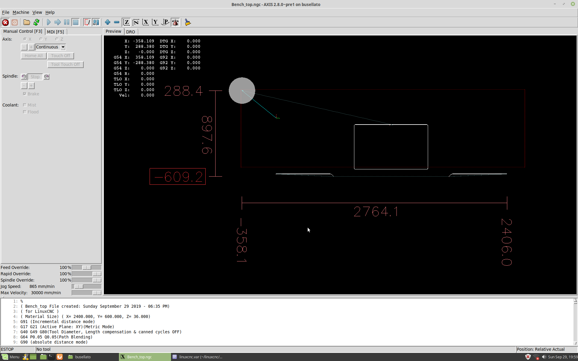

This has me so incredibly stumped after a couple of hours, I have to ask for help. I've only cut a few pieces, so still new at this.

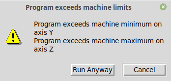

When I try to run my program, I get Y minimum and Z minimum out of machine limits. The preview confirms the problem in red.
The frustrating part is that I ran a test cut on a thinner piece just before, and all I did was touch-off the thicker piece!
In my tool table, T1 has an offset of 0,0 and my main router spindle T21 has an offset of -271.5,282.75.
I used T1 to set up G54 X/Y coordinates, then used T21 to set G54 Z and touch-off the tool length, seeing as it was the only tool I was going to use. (This is something I've never done before as I see the Z in the the tool table is 0.)
The only entries in linuxcnc.var are:which looks about right (altho' I don't understand why the Z parameter is zero?).
It's as if the tool offset is not being applied to the G54 parameters, but the program appears outside the machine limits at load so I wouldn't expect them to.
I tried setting G54 to T21 but doesn't seem to make any difference (the var params might be from that point).
The head of my Gcode looks like this:(Don't know why the G91, then the G90 - any ideas accepted!)
I apply a G43 after the tool change, but I've changed it since to be done in the toolchange remap function.
I've attached my HAL and INI files just in case, but don't really think they are an issue; I strongly suspect it is some simple switch in the GUI I've missed.

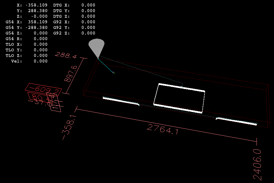

EDIT: My spindle configuration is like this, altho' not fully populate in tool.tbl yet:
View in perspective mode showing error in Y and Z:
Actual error message:

29 Sep 2019 08:49 #146562
by pl7i92
Replied by pl7i92 on topic Having trouble with Coordinate System on multihead router.
hi
first the error showes the g-code out of limits in Y nothing to do on Z
so did you Touch_off part G54 with the tool that is zero in tooltable usaly the first all otheres are mesurerd agaiunst this Z value
multitool so did you only got one spindle in playce or are the spindles apart

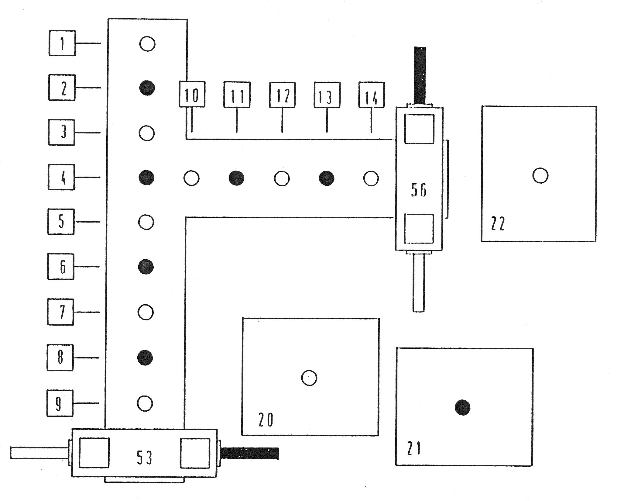

Three router spindles and a bank of drills as per the tooltbl.txt attachedmultitool so did you only got one spindle in playce or are the spindles apart

29 Sep 2019 19:46 #146656
by HueyHQ
Replied by HueyHQ on topic Having trouble with Coordinate System on multihead router. - SOLVED (CAM issue)
I tried systematically changing the reference to T9 and setting the tool heights, with the same result.
Had another look over the G-code and found this in the middle:
The CAM program had added the default tool #1, even though the text said "End Mill (12 mm)" indicating tool #21.
I had to explicitly select T21 again, and all was good again.
Something to watch out for in the future, I guess!
T1 M6 ;End Mill (12 mm)
G43 H1
S12000 M03The CAM program had added the default tool #1, even though the text said "End Mill (12 mm)" indicating tool #21.

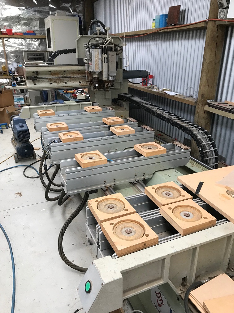

30 Sep 2019 01:45 - 30 Sep 2019 01:47 #146684
by pl7i92
what cam are you using
can you post a image of this realy interesting tool setup on the mashine

01 Oct 2019 02:17 - 01 Oct 2019 02:19 #146787
by HueyHQ
I'm using an older version of Vectric Aspire - came with the machine, and it works mostly for what I need.
The images are not the best; I am away from home and these are the only ones I found:
