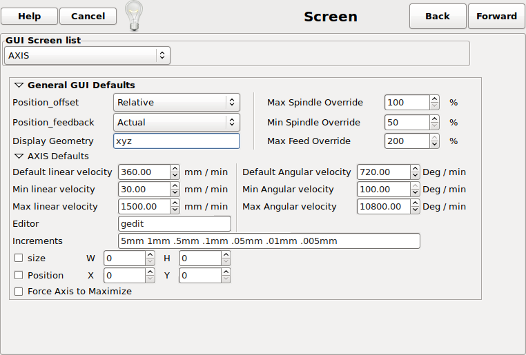

2.8.0-pre1 XXYZ gantry Axis preview toolpath stretched in the X direction

i think the source of pncconf should be reviewed. This might be caused by a bug in it writing out the wrong geometry string.
Replied by rodw on topic 2.8.0-pre1 XXYZ gantry Axis preview toolpath stretched in the X direction
That was the problem. Changing to GEOMETRY = xyz resolved it.
Thanks Todd!
Scott

github.com/LinuxCNC/linuxcnc/blob/0892a4...pncconf/data.py#L289
It then sets [DISPLAY]GEOMETRY to what is in the Display Geometry entry in the following screen
It did work fine on a xxyz config and a xyyz config created just now
Replied by phillc54 on topic 2.8.0-pre1 XXYZ gantry Axis preview toolpath stretched in the X direction
Pncconf defaults the Display Geometry to xyzi think the source of pncconf should be reviewed. This might be caused by a bug in it writing out the wrong geometry string.

10 Feb 2020 03:22 #156928
by shasse
Replied by shasse on topic 2.8.0-pre1 XXYZ gantry Axis preview toolpath stretched in the X direction
The error in this case was definitely mine. pncconf allows you to specify a correct configuration, I was just overzealous putting xxyz for both axis geometry and trajectory. Following Todd's suggestion, I was able to generate a correct config using pncconf.

I have an idea of what your problem may be. Could you post a copy of your ini file.
That was a pretty inspired guess!

Replied by Todd Zuercher on topic 2.8.0-pre1 XXYZ gantry Axis preview toolpath stretched in the X direction
Well I've seen similar behavior before. My XYZW machine behaves the same way with the Z and W moves being additive in the display.
