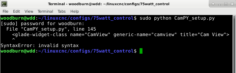

I am trying to get camview to run in a tab in axis. I have followed the instruction in the readme file and it runs great as a standalone but i just get a blank tab in axis. I think i may need to run CamPY_setup.py but I get the following message when i try. See screenshot.
I am running Deb 9 Stretch Linuxcnc 2.7.14
Thank you
Thank you

Could you post the camPy program?
If all else fails you could add this line manually to the appropriate file but lets see if we can fix the script - it seems Norbert doesn't have as much time for linuxcnc as he used to.
Chris
Chris

Here is the basic process to add widgets to the GLADE editor.
wiki.linuxcnc.org/cgi-bin/wiki.pl?GladeV...dget_to_GLADE_editor
I involves 3 files.
Then you need to add camview.py to the folder that hal_pythonplugin.py is in.
Let me know if you need more detail.
Chris
I involves 3 files.
<glade-widget-class name="CamView" generic-name="camview" title="Cam View">
<properties>
<property id="size" query="False" default="1" visible="False"/>
<property id="spacing" query="False" default="0" visible="False"/>
<property id="homogeneous" query="False" default="0" visible="False"/>
</properties>
</glade-widget-class><glade-widget-class-ref name="CamView"/>from camview import CamViewThen you need to add camview.py to the folder that hal_pythonplugin.py is in.
Chris

Got it working. Thank you so much Chris.
