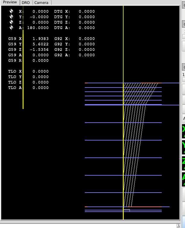

Blue lines in Axis toolpath display

Replied by tommylight on topic Blue lines in Axis toolpath display
That is new !
- Posts: 7368
- Thank you received: 2181
25 Feb 2020 20:19 #158487
Replied by cmorley on topic Blue lines in Axis toolpath display
If that is a new install then I'd guess an OpenGL issue.
Maybe you could try software rendering.
If it's an old system that did work but now doesn't then i would be looking at hardware issues.
