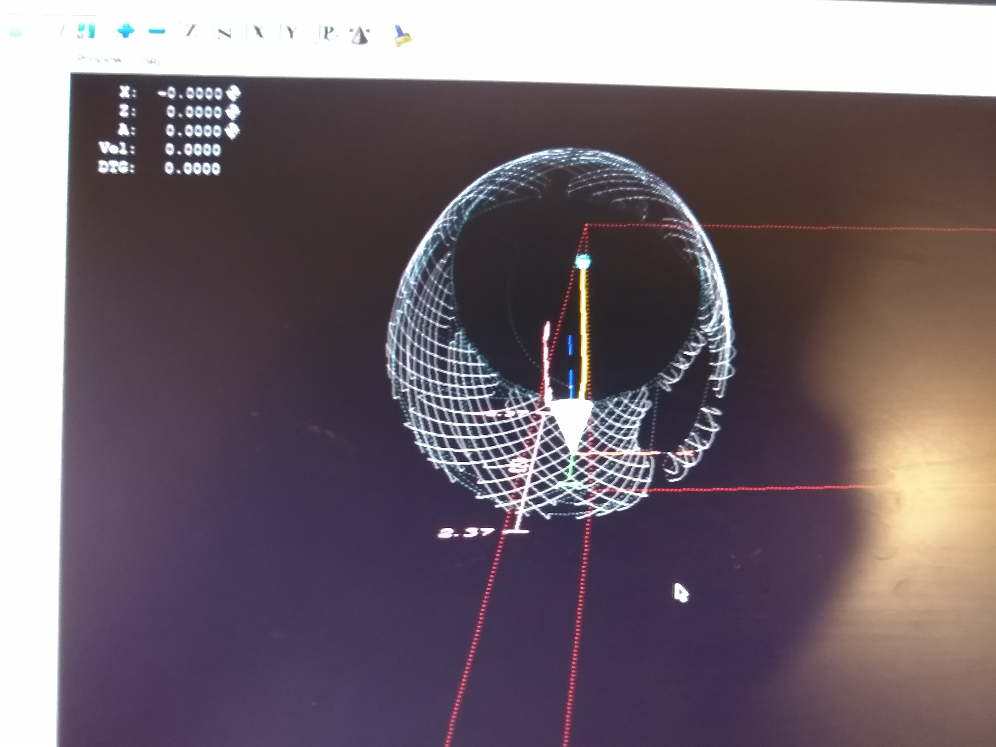

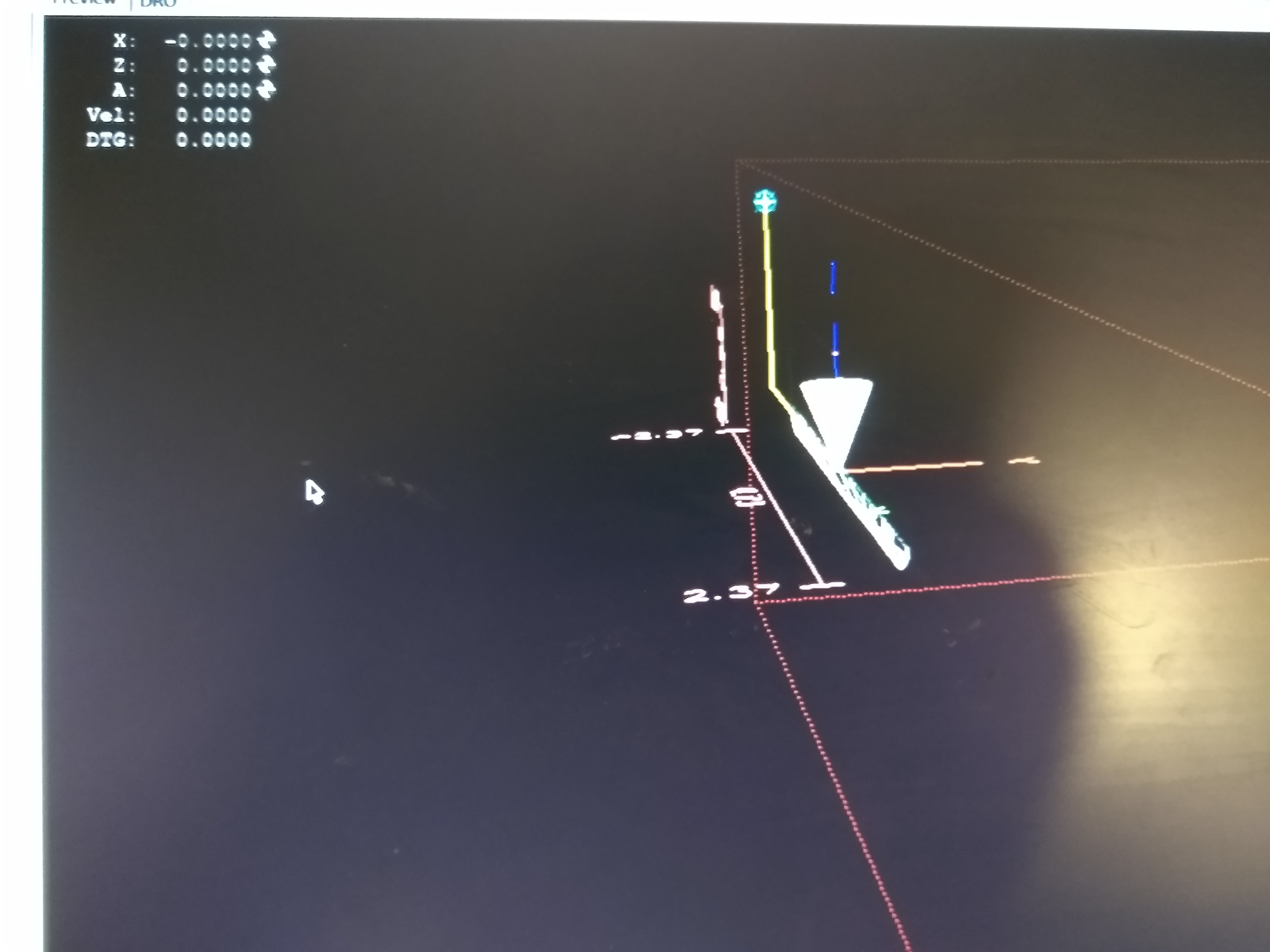

I have a dedicated rotary CNC for making drums. I can go up to 22 inch diameter, but normally do 14 inch. The A axis rotates around the X axis. There is no Y axis.
In the INI file, under [DISPLAY] I have tried both : GEOMETRY = XZA & GEOMETRY = AXZ.
In the attached photos, both are using the exact same gcode file. The one with the cylinder is the AZX. This is perfect, except it shows the cone inside the cylinder. The other photo is XZA setting, which I do not find as useful (but it does have the cone on the outside).
Is there any way of showing the cylinder with the cone outside?
I am fine if this is as good as it gets, but my bullheaded personality wants it perfect.
Thanks for any help.

Have you tried -AZX?

I had tried -AXZ, and XZ-A, but not -AZX (or ZX-A).
Thanks for the suggestion, but it did not change anything. Same results.
