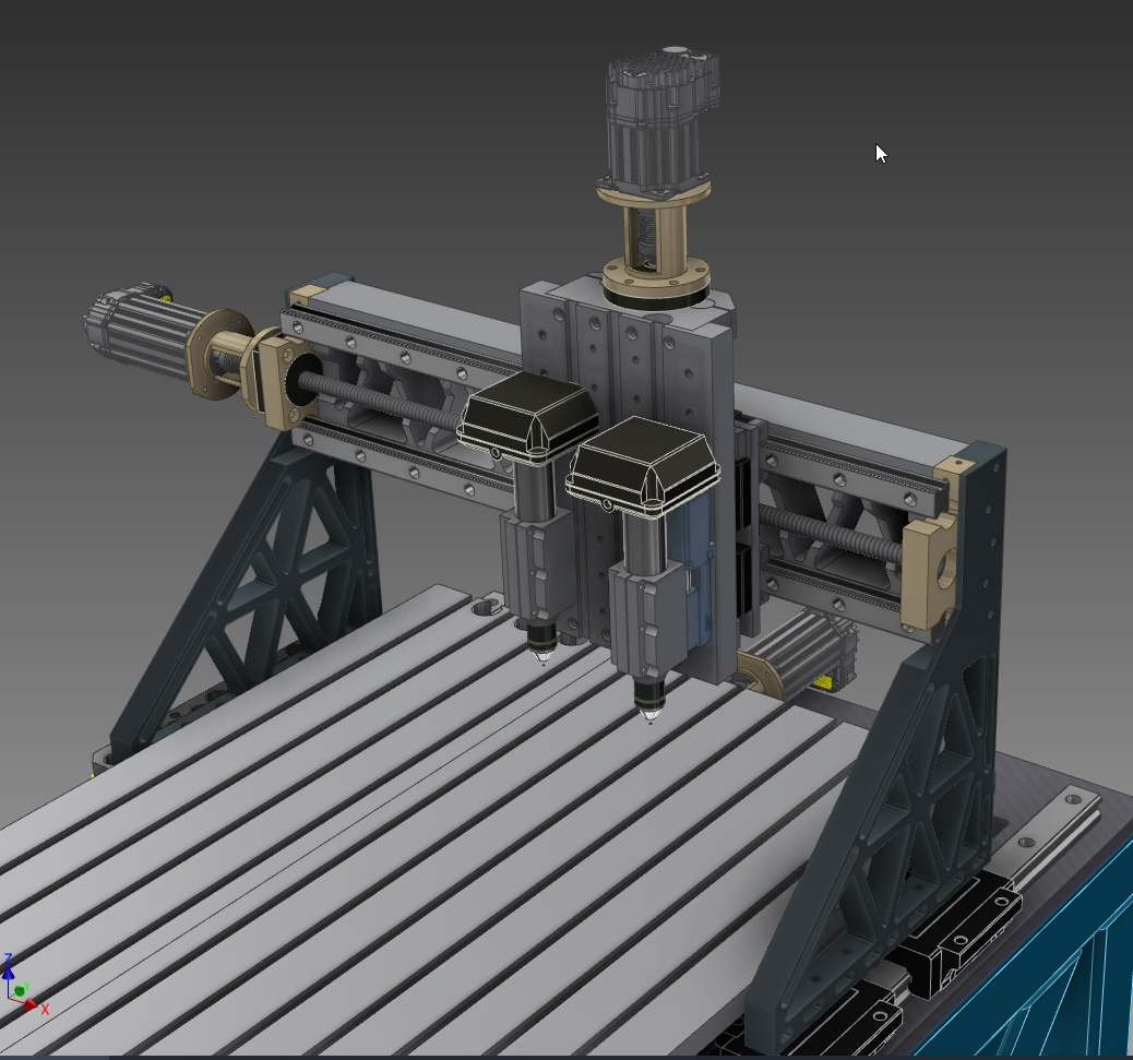

Hello, my machine will look like the one in the picture below.
As we can see the first camera (the one with low magnification) is attached to the Z axis plate and the second high magnification camera is mounted on the Standa precision rail (shown in faded blue in my image) which can be called A. The position of the first camera depends only on the Z axis whereas the position of the second camera will depend on both Z axis and A axis and they both are parallel to each other.

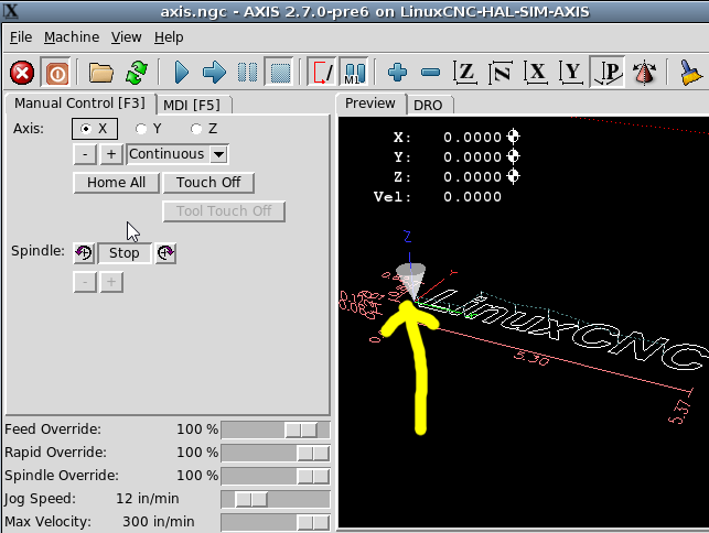

Currently when I open the emc axis_mm I just have a single cone as you can see in the image below but in my case I should have 2 cones(dual spindle).
And at the end if everything works as planned, when I change Z both cameras should be moving and when I change A only the second camera should be moving.
Can someone help me on this?

11 Sep 2020 16:53 #181773
Replied by Todd Zuercher on topic how to implement a dual spindle system (Z and A)
It sounds more like your second camera would be mounted to a 2nd parallel Z axis. This is customarily given the axis letter W. The axis letters A,B, and C generally refer to rotary axis about the X,Y, and Z axis respectively.
I have several CNC routers running Linuxcnc, set up with two spindles mounted to separate parallel Zs one called Z and the other W.
However I do not know of a way to make the display show two tools. (I do not think it is possible without rewriting the display program.)

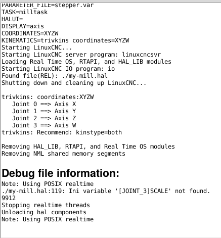

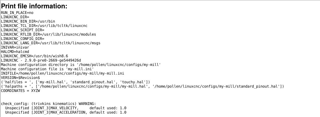

13 Sep 2020 23:38 - 13 Sep 2020 23:44 #182043
by kevin19
Replied by kevin19 on topic how to implement a dual spindle system (Z and A)
Last edit: 13 Sep 2020 23:44 by kevin19.

14 Sep 2020 06:04 #182055
Replied by Aciera on topic how to implement a dual spindle system (Z and A)
The values for joint_3 in the INI are commented out.
Warning: Spoiler!
[JOINT_3]
#TYPE = ANGULAR
#HOME = 0.0
#MAX_VELOCITY = 90.0
#MAX_ACCELERATION = 360.0
#STEPGEN_MAXACCEL = 396.0
#BACKLASH = 0.000
#SCALE = 40
#OUTPUT_SCALE = 1.000
#MIN_LIMIT = -36000.0
#MAX_LIMIT = 36000.0
#FERROR = 5.0
#MIN_FERROR = 1.0
#HOME_OFFSET = 0.0
#HOME_SEARCH_VEL = 0.0
#HOME_LATCH_VEL = 0.0
#HOME_USE_INDEX = NO
#HOME_IGNORE_LIMITS = NO
#TYPE = ANGULAR
#HOME = 0.0
#BACKLASH = 0.000
#SCALE = 40
#FERROR = 5.0
#MIN_FERROR = 1.0
#HOME_OFFSET = 0.0
The following user(s) said Thank You: kevin19
