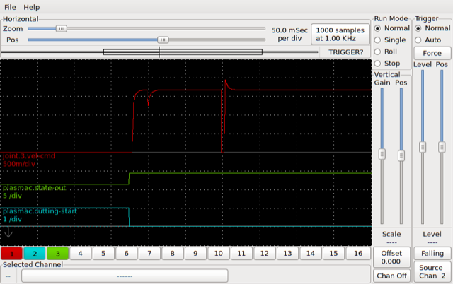

I'm not necessarily sure I know how to describe this issue as it pertains to Axis... but I'll do my best.
I run PlasmaC loaded on top of Axis. I've been having this issue for quite some time that manifested itself as a "Joint_3 Following Error". Just to be perfectly clear, the root cause of the following issue for Joint_3 is not a setup/tuning issue. The issue only showed up on a end of program, on the final M5 command which causes PlasmaC to retract the torch, OR when the user stops the program (via the GUI or a keyboard shortcut).
I always thought it was a PlasmaC issue, and subsequently caused PhillC to pull out his hair trying to find it. Halscope plot after halscope plot showed a weird "blip" in the Joint_3 commanded velocity on torch retract during either the last M5, or after stopping a running program during a cut. Every time. The blip goes from full velocity to 0 to full velocity in a very short time period, which due to the nature of the quick acceleration commands that seem to break the accel setting constraints, sometime causes a Joint_3 Following Error.
Axis Plot (note the blip in joint.3.vel-cmd):

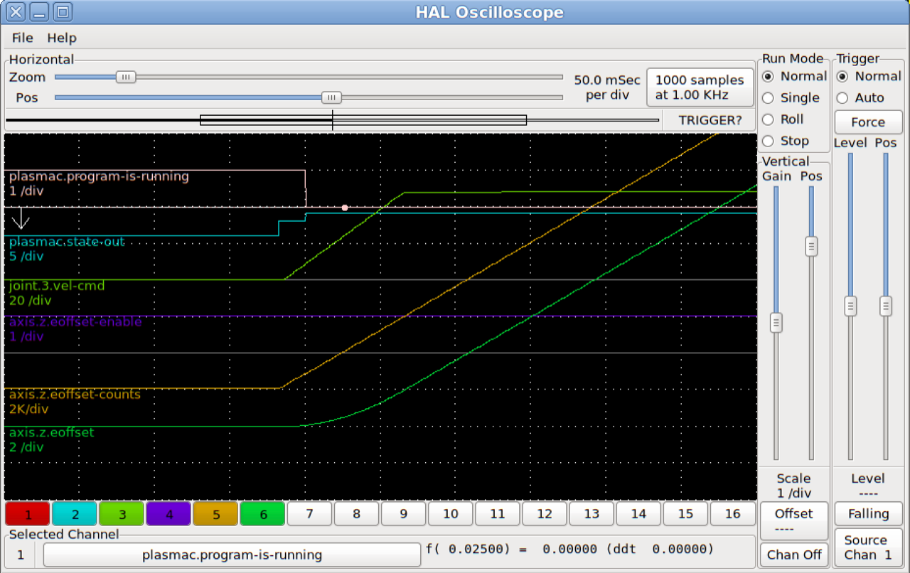

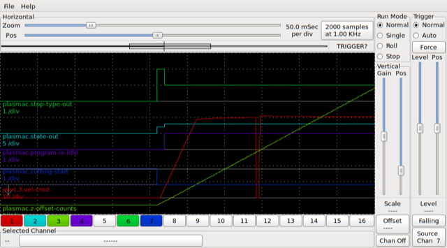

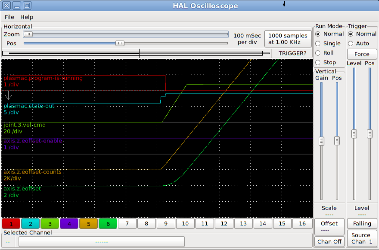

At any rate, a random, but literal "shower thought" caused me to have Phill check Gmoccapy to see if the issue existed in that GUI. If the issue was present in another GUI, it would be a PlasmaC problem and not a GUI problem. He also ended up checking the new GUI he is working on (QtPlasmaC) as well.
The results are that neither Gmoccapy nor QtPlasmaC exhibited the issue.
Gmoccapy:

I'm not really sure where to go from here. While I can navigate the Plasmac.comp for the most part, I am not at all familiar with Axis coding at all, and have no idea what to even look for.
Hopefully all of that was clear. That's weeks of testing/trying to logically break down the problem typed in a few paragraphs. Thanks for any help/insights you're able to provide, and I'm happy to answer any questions that might help get whatever is causing this resolved.
