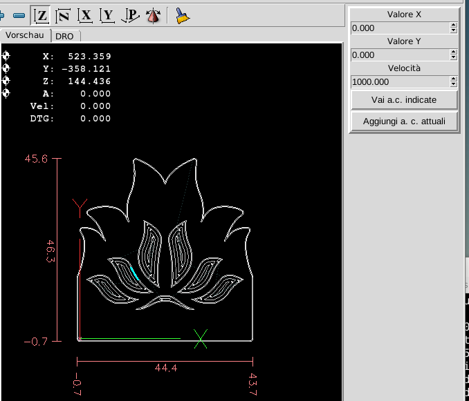

I'm trying to more customize my GUI.
In particular, I'd like to add 3 spinboxes to input 3 values (X, Y, F), then 2 buttons to use these values, in this way
- 1st button: by pressing it, go to the input coordinates XY at speed F
- 2 nd button: by pressing it, add the values (X and Y) to the current position, then go there at the speed F
I started by modifyig custompanel.mxl, creating the 3 spinboxes and the 2 buttons:
Then, custom_postgui.hal
Then my file INI:
Finally, created the macro file:
But the thing doesn't work...
After inputting the 3 values and hitting button 1 (go to the coordinates), I get an error message:
After a couple of useless tries, I decided to try some test, by modifying the macro.

By chance, I tried this:
The carriage moved to the specified position, at specified speed.
At this point I can't understand.....
The syntax is the same, but why the F parameter is accepted (defined) but X and Y don't?
Why G0 doesn't work but G1?
Andrea

- Posts: 22012
- Thank you received: 7492
16 Nov 2020 18:38 #189528
Replied by tommylight on topic Add spinboxes to GUI to input values
G0 does not use feed rate, it moves at the max allowed by the ini settings.

16 Nov 2020 23:12 #189557
by MaHa
Replied by MaHa on topic Add spinboxes to GUI to input values
Had a look at your problem, and modified a bit, just able to o<150> call from a program. It followed the input of the scale. When input numbers in scale make shure to hit enter, otherwise the numbers are just there, but not loged.
For test, the file were panel.xml and 150.ngc. Changed capital letters for halpin to lowercase and underline removed.

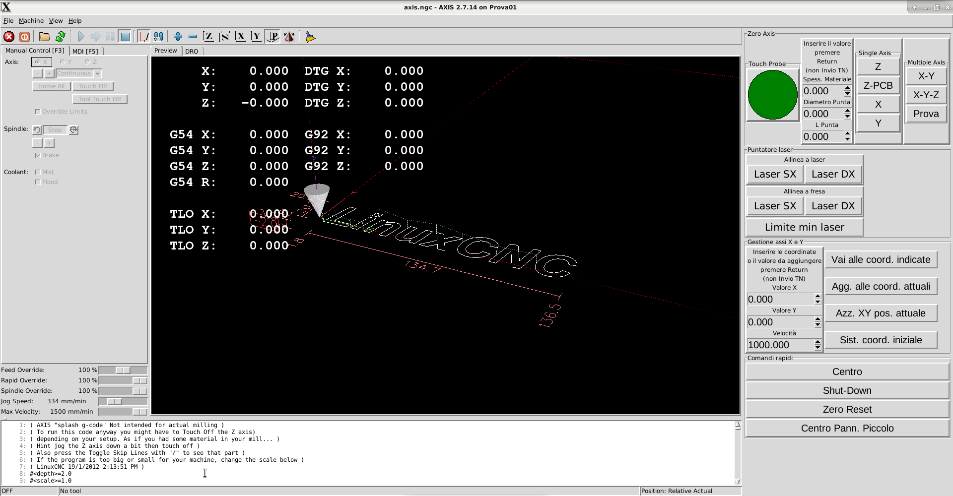

- Jocman
- Posts: 111
- Thank you received: 11
17 Nov 2020 08:12 - 17 Nov 2020 08:17 #189578
by Jocman
Replied by Jocman on topic Add spinboxes to GUI to input values
About hitting Enter (not the one in the numeric keyboard), I know about this issue, and check it evrytime (without "enter" the values are not "decimal" - it miss the decimal values)
I'll try your suggestion as soon as I back home from workplace.
BTW, to create this feature, I followed the same step used couple of months ago to create a zero procedure for the 3 axis using an aluminium square.
Even in this case, I used 2 spinboxes to enter 2 values (material thickness and bit diameter) and a button to launch a macro.
The structure of the files (INI, HAL, XLM) are similar to the one used for this topic, but in that case the procedure works fine, with no error and no need to delete underlines.

18 Nov 2020 08:33 #189650
by Jocman
Well, after studying the MaHa suggestions, I decided to make a step-by-step check.
And the first thing I did was relative to the Maha's suggestion about the use of all lowercase letters and no underscores.
After fixing all the lines in the various files, the thing worked perfectly.
The only thing that leaves me a little bit confused is that reading the forum in the past, I read the advice, when operating in HAL environment, to use always lowercase letters and avoid to use "Windows style" characters, like the space, and use the underscore instead of space.
If my mistake about the lowercase is plain, the use of underscore seemed to me recommended. Could it due different versions of LinuxCNC?
Beside the fixed problem, I would ask (keeping the spinboxes problem) how (if possible) can I set the length of the spinbox. currently all my spinboxes are about 10 cm wide, but 2 cm will be more than enough to input a value.
I found a topic in the forum about the same issue, but no solution.
Analyzing some XML files found in several topics, I've seen the use of parameter <width> for spinboxes, and the attached image showing a short spinbox. But in my XLM the parameter gets no effect.
Same even about some buttons, thy are very wide (too wide...) Eventually, the side custom panel steals a lot of space to the axis preview window....
Is there really no way to manage the widget dimensions?

Well, it seems the only way to deal with the widget dimensions is playing with the font dimension and the text line length (so as Maha sayd)
Played a little bit with both features, and got a nice results, and doubled the AXIS preview
Thanks very much to all, guys.
