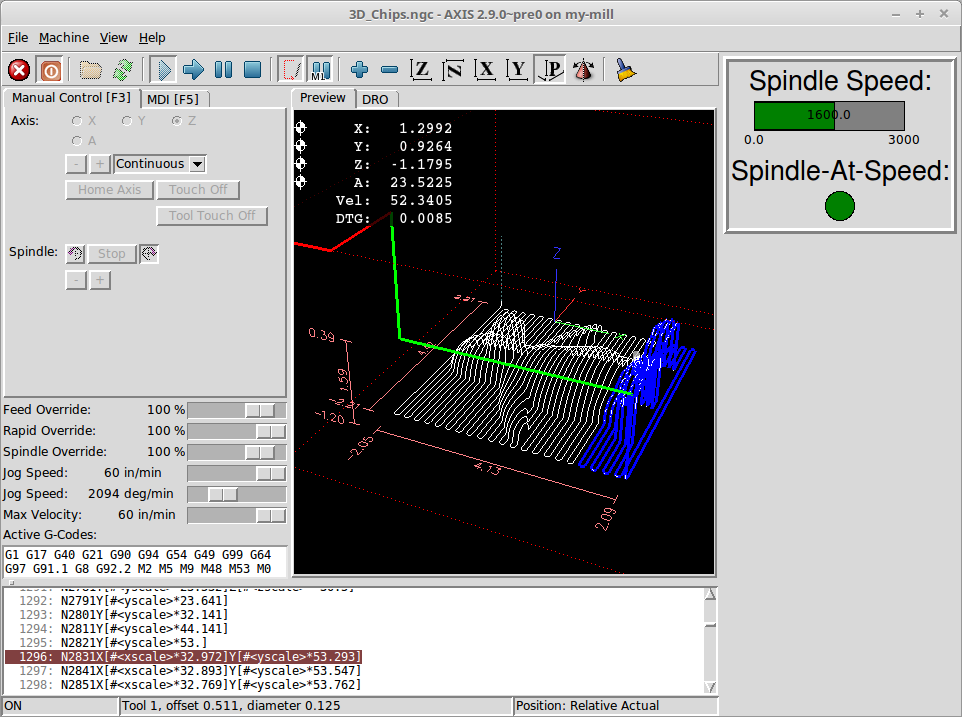

After having a crash on the same location twice, iIt took some serious troubleshooting to find the cause.
I found I had a rapid going through the material which went through because of making a programmed corner in to a smooth rounded corner.
But the path was shown in dark green brown and that was lost in a sea of a black background and white and red traveled milling paths.
So I'd like to change the color of the path of the rapids that were actually traveled.
Do any of you know where this color is programmed?

Replied by tommylight on topic Changing the color of rapids path
What GUI?
- Posts: 7368
- Thank you received: 2181
26 Dec 2020 04:59 #193210
Replied by cmorley on topic Changing the color of rapids path
rs274/glcanon.py
class GLCanonDraw:
This class's variable 'colors' set the colors of drawing for all the popular screens
Chris
class GLCanonDraw:
Chris

ok then, with the recent updates from last week, lets get this going on axis now , someone help me out with this
we have 2 commits
axis/extension/emcmodule.cc
github.com/LinuxCNC/linuxcnc/commit/8acb...deafe67d7ad17b355c44
and the qtvcp qt5_graphics commit
github.com/LinuxCNC/linuxcnc/commit/94a7...891b4254a7ec3c8897f0
with the emcmodule changed, i should be able to pass the part from qt5_graphics, into axis.py via usercommand.py
that doesnt get me any errors, but i do not know how to set them for axis. I have an example from cmo for the qtvcp way
, but now to translate to axis, im not sure, i dont exactly understand self very well, but Im not sure what i should be calling on,
im just trying to tie it into a button to test
self.w.gcodegraphics.set_plot_colors(jog=(255,0,0,255))
not sure what I should change this to, or if im even on the right path. im trying out things like
" LivePlotter.set_plot_colors(jog=(255,0,0,255))"
"GlCanonDraw.set_plot_colors(jog=(255,0,0,255))"
"self.o.set_plot_colors(jog=(255,0,0,255))"
would the "def set_plot_colors" even go into axis.py or would it go into a different extension?
if axis.py is correct, do i need to put it into a different class or something?
